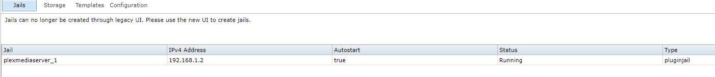

Good afternoon all...
I wanted to re-visit this thread as I am having problems. I followed the instructions that @shamo316 provided and something doesn't seem right. When I created the jail in the new GUI, I selected 11.2 version and gave it an IP of 192.168.1.3 (old Plex jail was 192.168.1.2). I then went through the shell commands he provided. When I navigate to the new IP (and in my mind, the new jail), it seems to load the OLD jail and plex version...To test, I stopped the old jail, while keeping the new one running, and it doesn't load (says it can't find server). Any ideas on why this is happening? FYI - I used the Plex Pass version when I ran the commands.
Thanks!

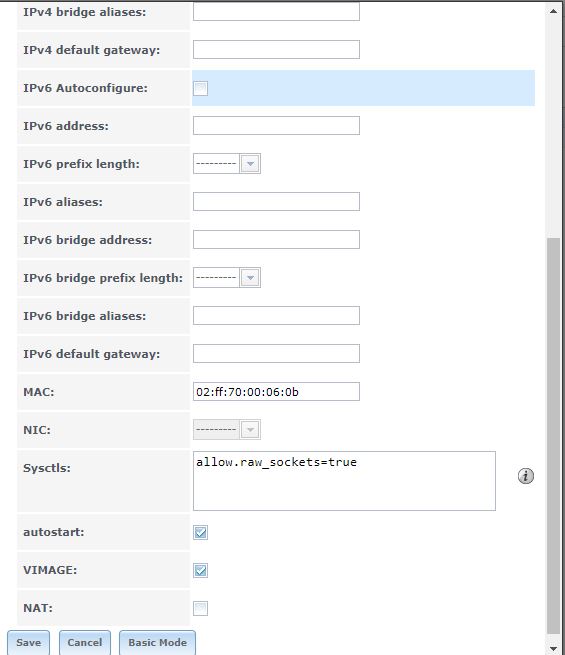

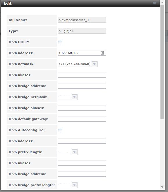

Did you create the new jail manually from the Shell, or did you use the Jails interface in FreeNAS? I suspect that something is not quite right with your networking.
Let's start with some basic information:
1) List your system specs (as per forum rules)
2) From the Shell, run the following command: "iocage list" (without quotes), and post the output
3) From the Jails interface in Freenas, capture a screenshot of Basic properties and Network Properties for each jail.
Once we have some insight into your system, we can begin to offer suggestions.
Tartan88
Oct 4, 2016
24
@pschatz100,
Thanks for getting back with me. I created the new jail via the 11.2 WebGUI interface and not the shell...I agree with your suspicion, but am kind of stumped. To answer your questions...

2) Running the command you provided from the UI shell provided no results (it gave JID/NAME/STATE/RELEASE/IP4 headers, but nothing else? Should I run it from within the jail shell?)
3) I deleted the jail I tried to create for this new instance of PLEX, but within the old/legacy interface (and within the shell for my old jail for Plex) I looked at the basic jails screen and the settings for the legacy PLEX jail I currently have. They are attached.
Does this help? Thanks in advance!

pschatz100
Mar 30, 2014
1,184
System specs includes hardware...
At any rate, I am confused by what you did. If you run the command iocage list from the Shell, and it does not list any jails, then you do not have any iocage jails set up. Also, I suspect that you do not have your networking set up properly. From the screenshots you provided, it looks like you are using an old Warden jail (from old release of FreeNAS) - which has been end-of-lifed, so there are no more updates for that. Also, you are missing the parameter for Default Gateway. There could also be other issues with your setup. You could try setting the default gateway on the old jail using the Legacy interface - you might get lucky and things will begin to work again. But you still won't get updates to new versions.
The old jail will not interfere with any new jails as long as the IP addresses are unique.
I would start over. Install the Plexpass plugin according to the guidelines in the documentation. There are a couple of things you need to do for proper networking with Plexpass: 1) select VNET option when you create the jail, and make sure you have both ipv4 address and default gateway specified properly. If you get that far, things will be looking up.
