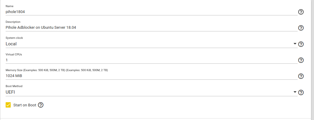

Boot checkbox is checked but it won't boot until I connect via VNC and click inside the window. The funny thing is that I do not have to confirm anything in the Ubuntu startup, just click in the black window and then the VM boots. I read that other users had the same issue so I lived with it until yesterday when I changed over to pfblockerng. More and more I come to the point that it is pointless to look for a solution if it is not available straight away. Freenas is a good device and serves its purpose but the VM's may not be that reliable. Yesterday I tried to install CentOS 8 and it won't boot unlike CentOS 7. Also reported by other users and no solution available. Again, we don't have to look for a solution if it takes too much of our time. The only reason why I put Pihole on Freenas was to save energy which I would otherwise need if I placed it on a separate computer. Now with PFSense in place, since it has lots of resources available, the job is better served by pfblocker. Plus I do not have to worry about Pihole failing and thus having no DHCP in that moment.

There's another checkbox in the VNC device settings that you need to uncheck. The VM should then restart automatically.

I own you a thousand kudos! You solved my half year long lasted headache. I would have never suspected that this box was ticked by default especially when you have the autostart option. While I understand that this option is useful when you want to troubleshoot the vm so for the VNC to wait until you click in. But to select it by default. Stupid...
Now I moved away from Pihole to pfblockerng but I will be using the VM for other purposes. Maybe the makers of PFsense will change the default to unticked in the next release (or have done this already - my VM's are quite old).

You need it on when you create the VM for installation from a CD/DVD image. That's why.
I always recommend configuring a serial console and removing the VNC device altogether, afterwards. For Linux or BSD VMs.
