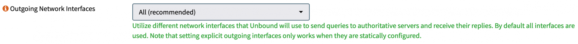

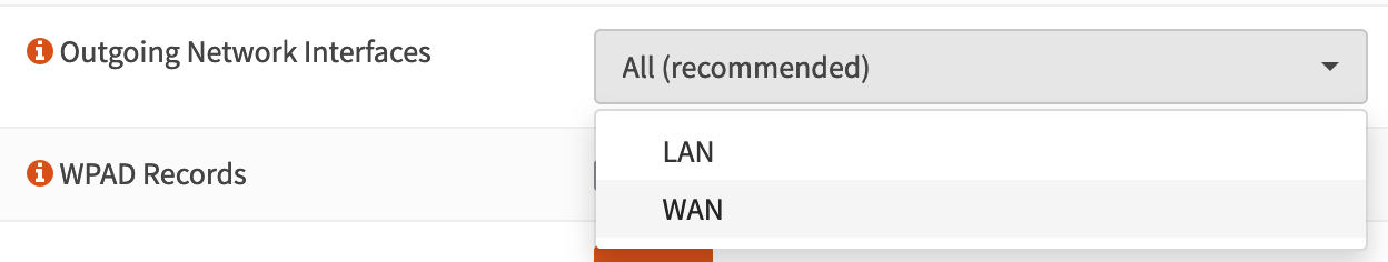

Well, isn't that interesting... There's this setting in the Unbound configuration, hidden behind an "Advanced" button:
The default, as you might expect, is "All." When I set it to WAN instead, it starts working. Wonder why that would be...
Including the LAN as an outgoing network interface is a peculiar choice. Failover WANs or VPN tunnels I could understand but not LAN.
15,504
The tooltip help indicates you can only specify an interface if that interface is statically configured. If that's the case, it would explain not setting it to WAN by default, because WAN for lots of people is DHCP or otherwise dynamic. The default is the same in pfSense, but for whatever reason it doesn't cause this problem.
That's kinda weird. I'm having a hard time figuring out why that would be a problem for Unbound.
