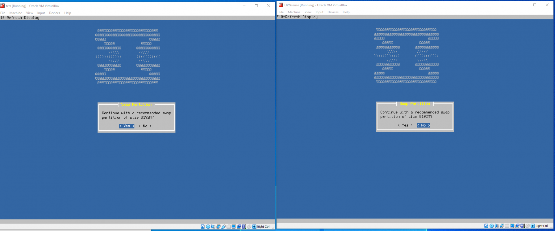

Just tried to install it under VirtualBox but can't get pass creation of the disk.
Not good.

I am trying to evaluate basic functionality of OPNsense, so running VM is somewhat a good enough way to go.
Unfortunately, I am being stuck at the install disk creation.
See screenshot with and without swap creation. It just stays there with no noticeable activity.
Installing pfsense as a VM has never been an issue.
This issue isn't documented as far as I was able to grasp.
I need to dig into it.
I am running on Windows 10 2004, AMD Threadripper 2950X with 64GB RAM and plenty of HDD and NVME storage space.

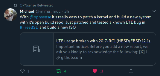

And, just in case, there was also relatively recent news of some patching:

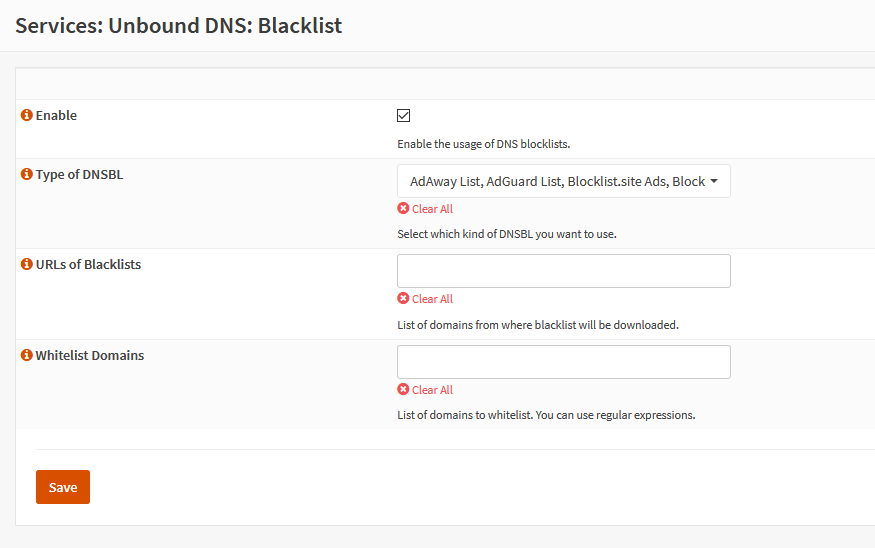

Patrick M. Hausen
Nov 25, 2013
7,776
With OPNsense 20.7 the os-unbound-plus package is obsolete and the blacklists are integrated into the standard unbound installation.
