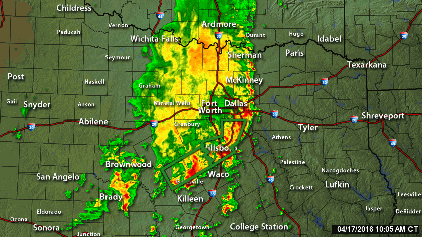

On top of all this, my area is in for thunder storms over the next three days. *long sigh*
