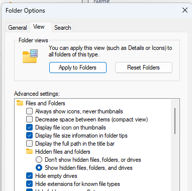

You should be able to access the snapshots on your windows client, they are stored in the root of the dataset in the .zfs folder, you must ensure the folder option is set to show hidden folders.

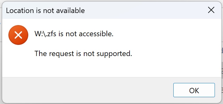

I can see the .zfs folder in Windows Explorer but Windows returns an error if I try to open it. I can CD into it in a command prompt but a DIR returns "file not found".
As the zfs folder is on the root dataset, I assume you have the smb share set on this dataset? If so have you checked the permissions on the share ACL to allow access?

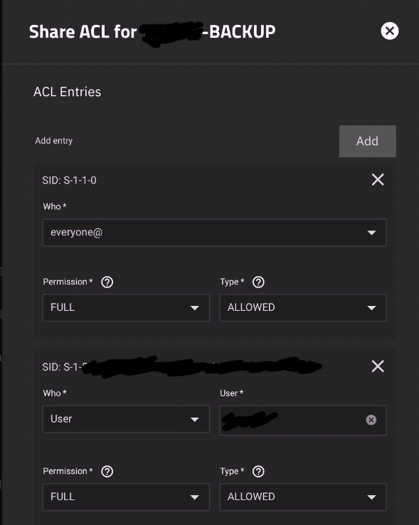

I've never needed to change the default share ACL to browse the dataset but I added an ACL for my user id granting me explicit access to the share but it didn't change anything.
Ignoring that, what happens if you manually type in Z:\.zfs\snapshot in the File Explorer address bar?
