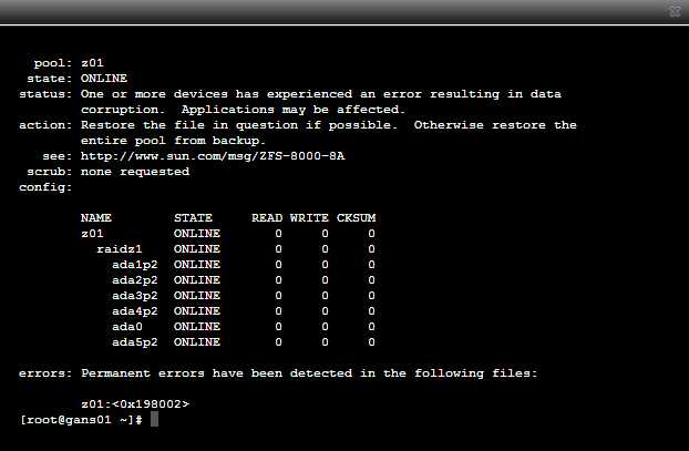

Hi.
FreeNAS 8.0.2 GUI showing permanent errors have been detected in the following files:
z01:<0x198002> but I can't find these files?
Anyone?
Thanks.

That shows that metadata in ZFS is corrupted. You should backup your zpool and recreate it.... as a RAIDZ2. RAIDZ1/RAID5 "died" in 2009. See the link in my sig for more information.
z01:<0x198002> but I can't find these files? .
Did you try clearing the errors and running another scub?
zpool clear z01
zpool scrub z01

Does a scrub "correct" those errors? I mean, it can't correct them because it has no parity... if it did it would correct them during a scrub. I just thought that if you do a clear and then a scrub they'll just rear their ugly head again.... would be interesting if the op did a clear, verified the "errors" went away, did a scrub and then checked to see if the errors came back...

I have cleared the error, but to no avail, even after doing a scrub. There is a 6.4Tb pool with 3Tb used and I don't have anywhere to back this up to now to even consider recreating the pool :(. This is where in a live environment when issues like this occur it gets me nervous!

Don't take this the wrong way, but it looks like you are trying to learn FreeNAS while using it in production. For example, your screenshot shows ada0 is part of your pool. FreeNAS always puts ZFS in a partition, so someone did that manually from the command line. As I was just telling someone else earlier today, if the GUI has the ability to do what you need it to do, you should be using it unless its broken. In this case, the replacement of whatever disk to ada0 should have been done from the GUI.
Additionally, and I'm not sure who's fault that is. But in a production environment a RAIDZ1 is completely unacceptable for reliability. RAID5/RAIDZ1 'died' four years ago. That's ages ago in computing. Why someone would willingly choose to use a configuration that is long since deemed unreliable is beyond me. About 80% of all users that come to the forum with lost data lost it solely because they chose to use a RAIDZ1.
When it comes to building file servers(not sure how much experience you have...) if you don't build it right the first time it will be nothing but a pain for the entire life of the server. Or you figure out what you did wrong and fix it in a way that it will never cause you problems in the future. It requires careful planning and execution.
As for the VM thing, its thoroughly documented that ESXi + NFS + ZFS = bad performance. Those 3 really don't go well together. If you search the forums there's lots of things you can try, but it will require you to tune ZFS, buy more hardware, or both. I'm not sure if your "main" NAS is a FreeNAS server, but I will warn you that we've had users that have lost their pools because of kernel panics. Partially saved data shouldn't trash ZFS, but people tweak ZFS in ways that makes that no longer true.
My understanding is that once you have corruption that is listed in zpool status the only way to correct it is to delete the offending item. In this case its metadata. I don't even know where I'd begin to figure out what that is actually for...

If you look at your screenshot it shows:
ada1p2
ada2p2
ada3p2
ada4p2
ada0
ada5p2
adaX is your device number, and p2 shows Partition 2 on the disk. Notice how ada0 has no partition designation. That's not how FreeNAS works if you replace a disk from the GUI. It would always create partitions. Even if you disable the swap space in the GUI(not recommended) the zpool would still have gone in ada0p1. So someone did a disk replacement some time in the past and did it from the CLI. Nothing bad about it, but its not something I recommend or endorse unless the GUI can't do its function. If the GUI couldn't' handle disk replacements there would be lots of complaints.

One last thing:
zpool clear -Fn z01
Don't forget the n and only report what it says, if anything.
Far past time to go purchase something to backup to then. 3 TB drives are certainly cheap enough.
