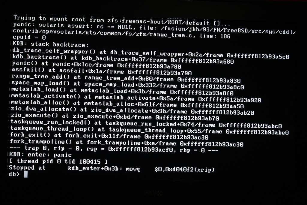

I am new to FreeNAS I have installed the version 9.3, turning on the FreeNAS the following error appears kdb enter panic thread pid 0 tid 100 415, is stuck in the cmd db> How do I recover my files, I have importance invaluable material on it.
PC Specs:
Semprom 2.6
Seagate 2TB
4GB DDR3 1333mhz
ECS a785GM-m
Printscreen FreeNAS with error:

You say you have invaluable data on there, yet you have half the recommended RAM (8Gb min), hopefully someone else can provide some insight. Hopefully this doesnt turn into a "lesson you learned the hard way"

Best you can do is add more memory and cross your fingers. Have you always been on 9.3 or did you upgrade? If you upgraded try going back to the older version you used.
There are minimum system specs for a reason and you now know the reason.

This *is* a pretty bad build---AMD Sempron, not enough RAM, not ECC RAM, not enough hard drives to actually make a proper NAS, and so on.
HOWEVER, that being said, I would have expected this to boot. He *does* have 4GB, and he seems to claim that it was working with 9.3 previously, if I read him correctly.
I expect something is actually WRONG with his hardware; something has failed.

I would try with a new usb stick to see if it boots

This looks like a trashed zpool. Probably the result of not having the minimum RAM.
This sure smells of "self inflicted failure" by not meeting the minimum requirements or using in appropriate hardware.

In this case the trashed zpool might only be freenas-boot though, or there's other corruption causing the panic. You might be able to recover with a fresh install of FreeNAS to a new USB stick, add 4GB more RAM, and then import your pool.
But if that is only a single drive, any data that is corrupted won't be able to be recovered from mirror/parity. You very likely have data loss.

Reinstalled system with 8gb ram, and imported the old hard drive and managed to save my data. Thanks for the help ones. I will adjust my system to a NAS future.

so was it adding the ram that fixed things or re installing FreeNAS?
