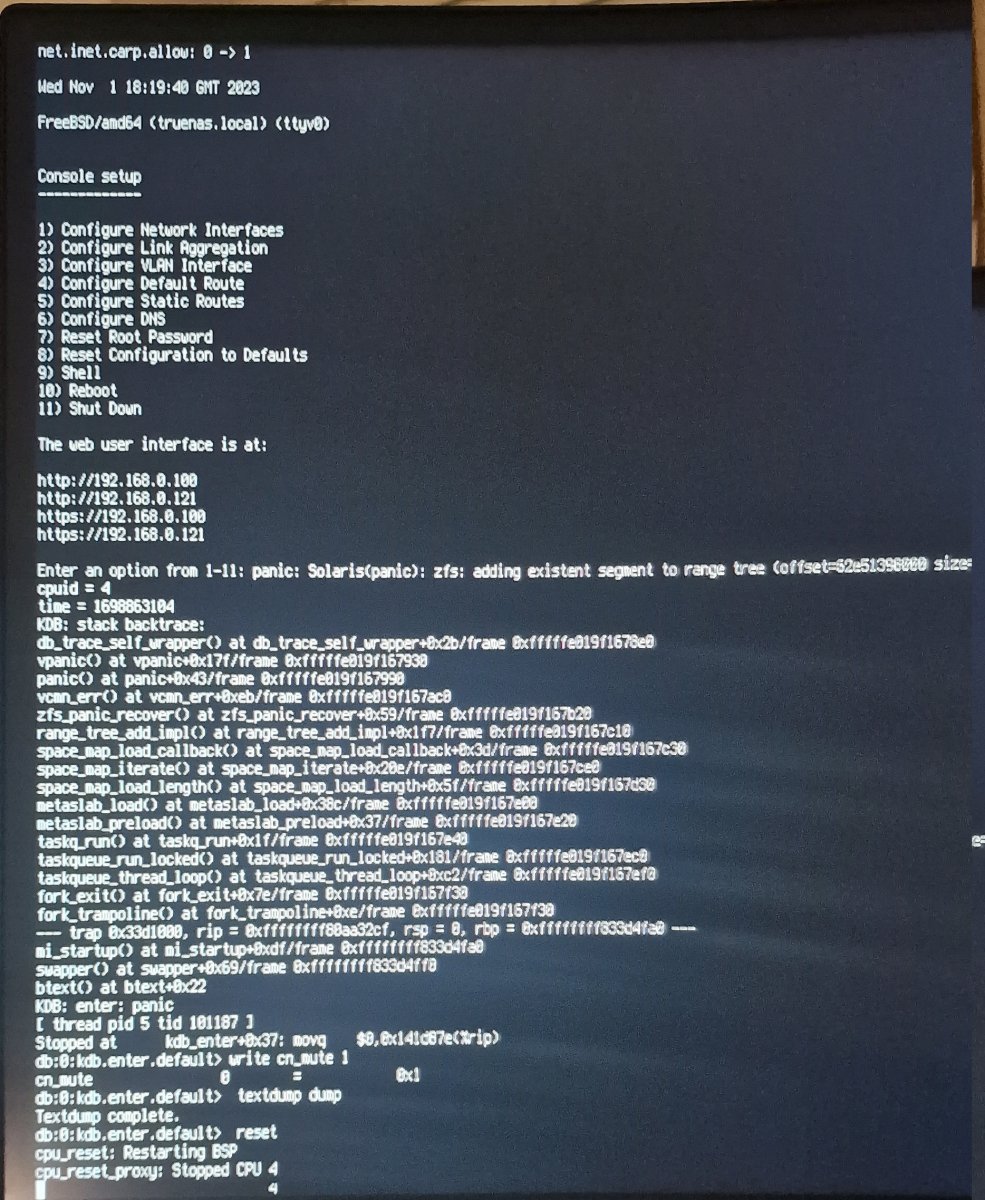

I hooked up a gpu and can see that the server boots just fine, and gives the usual console options and message "The web user interface is at: xx". However, a few seconds to a few minutes later, the server crashes with this error:
panic: Solaris(panic): zfs: adding existent segment to range tree

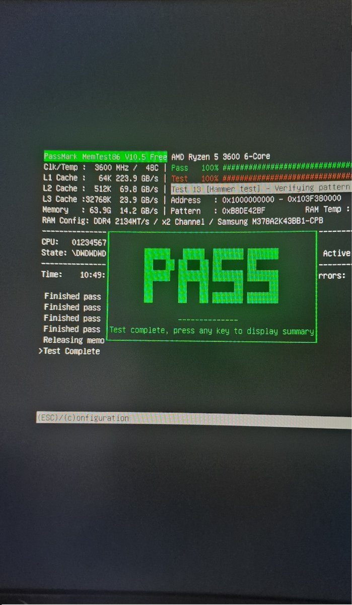

I've also ran a memtest overnight which passes, leading me to assume memory/mobo/cpu are unlikely culprits.

I have potentially narrowed down the error down relating to my "Tank" pool, as when i remove the HBA (with all HDDs attached) the system boots and is stable.
I tried to remove the HDDs one at a time to see if it was a specific drive, but the error and subsequent reboot occurred every time.
I read a few similar issues on the site, but they all relate to the issue occurring during the import of the pool, which I am not sure is not my case, as the system clearly boots and falls over later on ?
