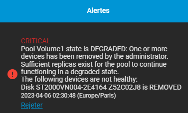

to complete the picture, this morning 6/4/23 pool is degraded
when i try to put ada2 on line manually I get messages /dev/ada0p3: operation not permitted

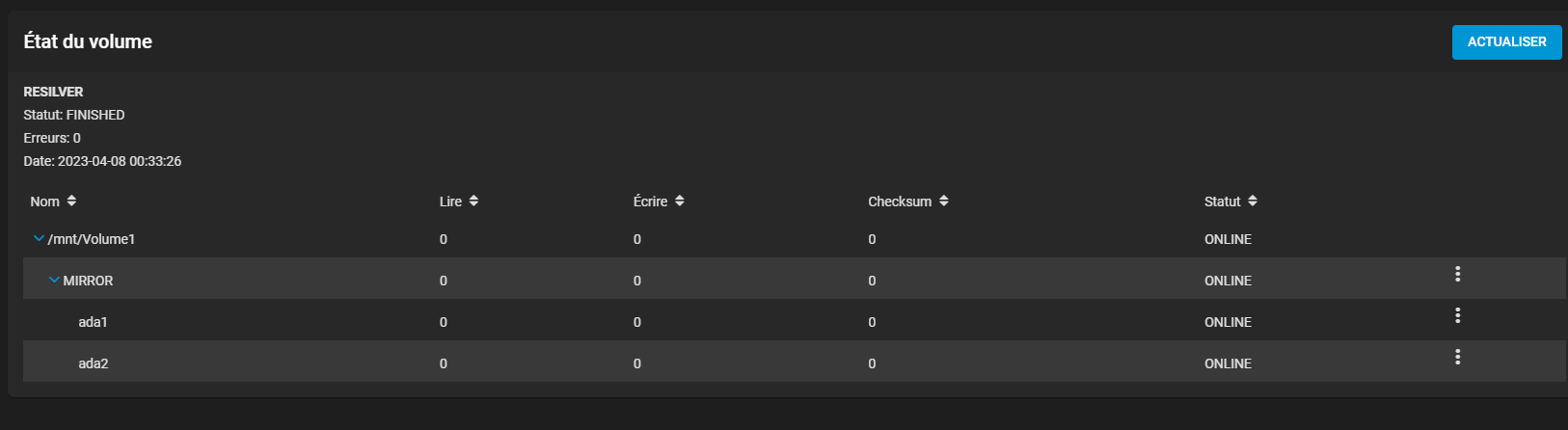

Well , tonight ada2 came back to live alone, but it seems always having messages operation not permitted.
Apr 8 00:00:00 SRV syslog-ng[1202]: Configuration reload request received, reloading configuration;
Apr 8 00:00:00 SRV syslog-ng[1202]: Configuration reload finished;
Apr 8 00:00:00 SRV ada2 at ahcich9 bus 0 scbus5 target 0 lun 0
Apr 8 00:00:00 SRV ada2: <ST2000VN004-2E4164 SC60> ACS-2 ATA SATA 3.x device
Apr 8 00:00:00 SRV ada2: Serial Number Z52C02J8
Apr 8 00:00:00 SRV ada2: 600.000MB/s transfers (SATA 3.x, UDMA6, PIO 8192bytes)
Apr 8 00:00:00 SRV ada2: Command Queueing enabled
Apr 8 00:00:00 SRV ada2: 1907729MB (3907029168 512 byte sectors)
Apr 8 00:33:21 SRV 1 2023-04-08T00:33:21.975432+02:00 SRV.local savecore 23224 - - /dev/ada0p3: Operation not permitted
