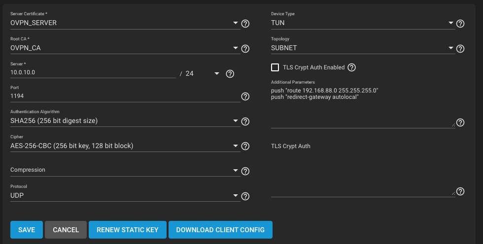

Hi, if your openvpn device type is tun (ip layer), and let's say you have local lan on 192.168.88.0/24, I think you should put
push "route 192.168.88.0 255.255.255.0" in the additional parameters of openvpn server setting page.
and setup route somewhere in your router as:
dst-addr: ovpn ip pool
gateway: turenas ip
