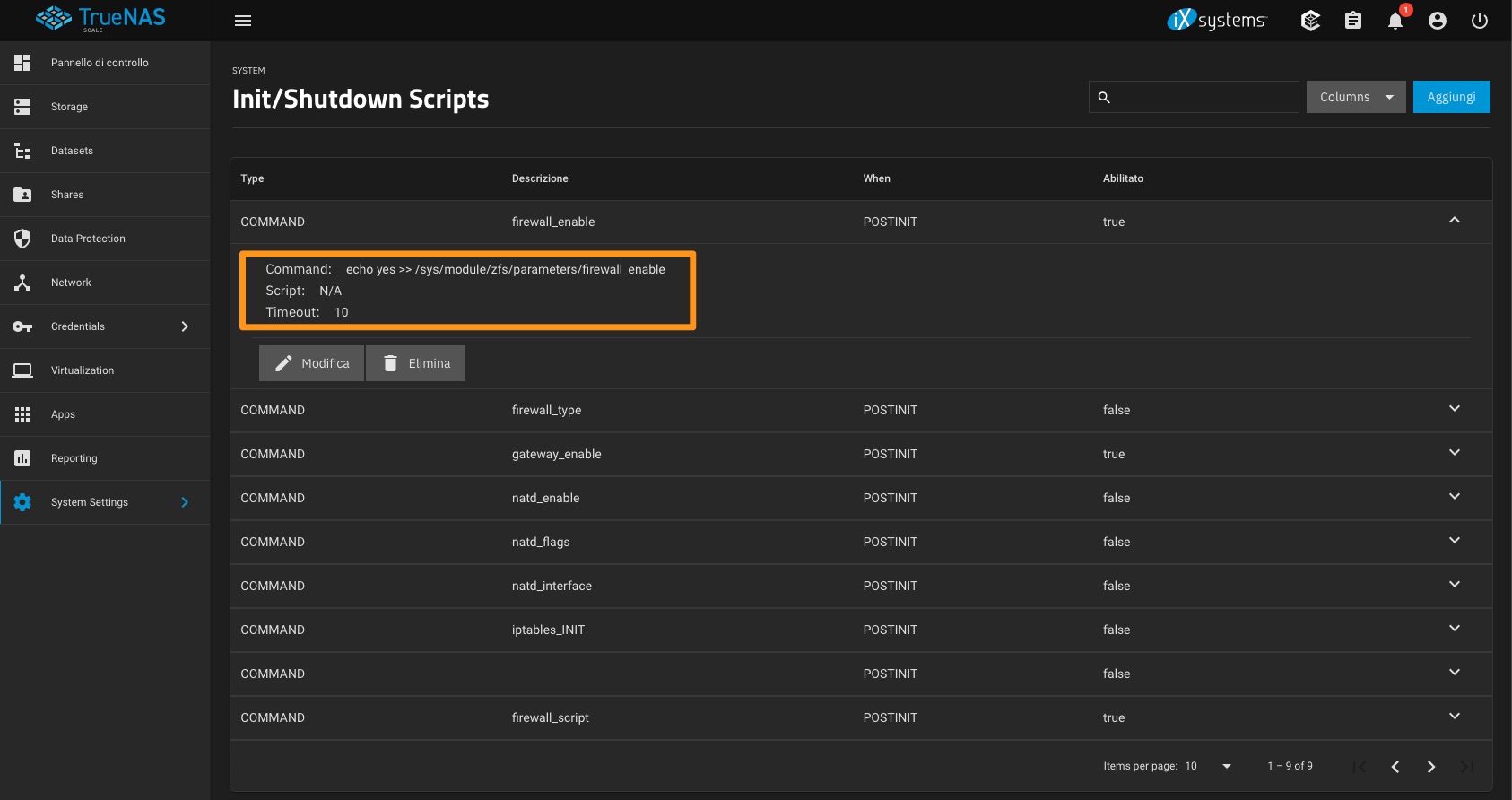

but I couldn't set up Tunables because on SCALE there is no such section and I did it differently in this way which I don't know if it is correct (TUTORIAL):

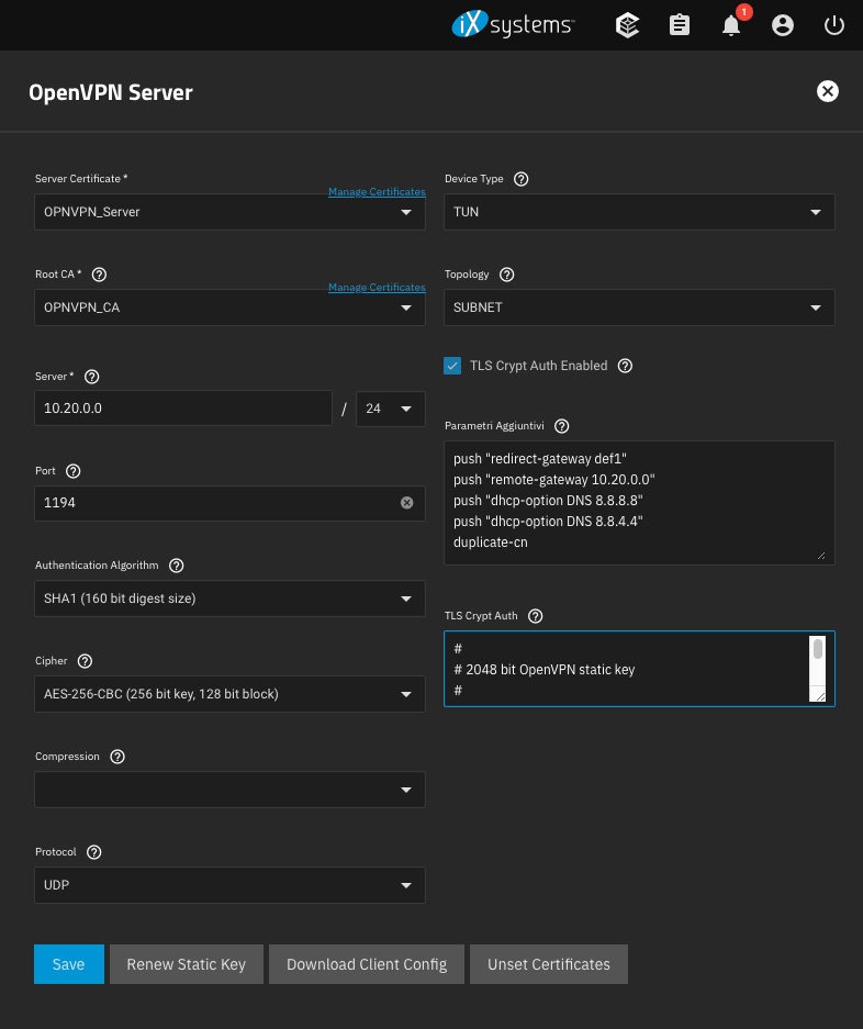

OpenVPN Server configuration:

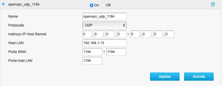

Port-forwarding:

With these settings connecting from WAN to the VPN I can only access 192.168.1.13 (NAS), while I would like to access the entire LAN (Through the VPN) and access the WAN (outside the VPN) while connected to the VPN, what are the correct configurations to be able to make the VPN work in such a way?

UPDATE:
I added in the Additional Parameters: push "route 192.168.1.0 255.255.255.0" and I can finally access my TrueNAS in http and browse WAN outside the VPN but I still can't access other devices on the LAN...

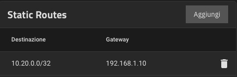

Do you have a route pointing back at the openvpn server on your LAN router?

Yes, i had setup port-forwarding to 1194
That's not what I mean...
How will all the other servers/devices on your network know where to go back to reply to requests from your OpenVPN clients... if they try to go to your router it will not know that network, so the packets will be dropped.
You need a static route to push those packets back to the OpenVPN server as it needs to route them to the clients.

I actually haven't configured anything other than port-forwarding on the modem, I have a modem that the operator provided me directly on loan, and there is no configuration for route pointing back...

I solved it by adding static routing directly from TrueNAS.
