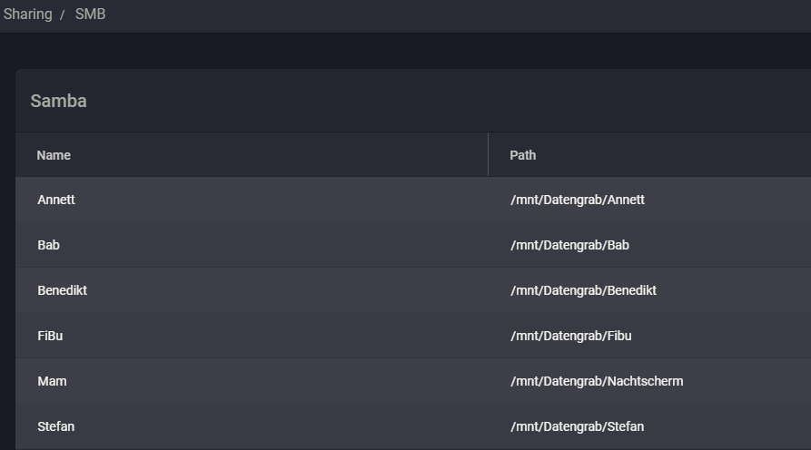

These should be available:

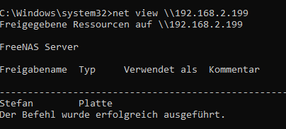

This is the only one which is...

Tnank you for the fast reply. Output is below. As expected, only "Stefan" is present.
