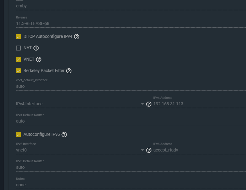

My NAS has two network interfaces.
My switch does not have link aggregation.
I would like to ask how to optimize the configuration of the network in this case?
If I plug in both my network cards,
It will cause my ASUS router (ax-88u)to crash. Or my NAS will be disconnected.
I set static IP 192.168.31.1 for the first network card.
The second network card I set up DHCP.
If I change the network configuration of the prison at will, it will also cause a crash.
My jails net configuration:

"1) Use the second interface for jails"
Thought it was much of a hassle because the second NIC has to be on a different subnet. Do you have an esay way to achieve it. Thanks.
Patrick M. Hausen
Nov 25, 2013
7,776
You can bring the second interface up without an IP address at all and bind all your jails VNET interfaces to it. FreeNAS will do that automatically via the bridge(4) pseudo interface. This way your FreeNAS "NAS traffic" will use one physical interface while your jails will use the other one effectively increasing your bandwidth. A bit ... and it depends ... but increase it will (as Yoda would put it).
There is no need for an interface to be on any subnet at all if you bridge other interfaces to it - which may then very well be on the same subnet as an arbitrarily different interface on the same box. Bridging is layer 2 ...
HTH,
Patrick
hervon
Apr 23, 2012
353
Created bridge1 using the other NIC. I use it of the jails. Seems to work. Thanks.
