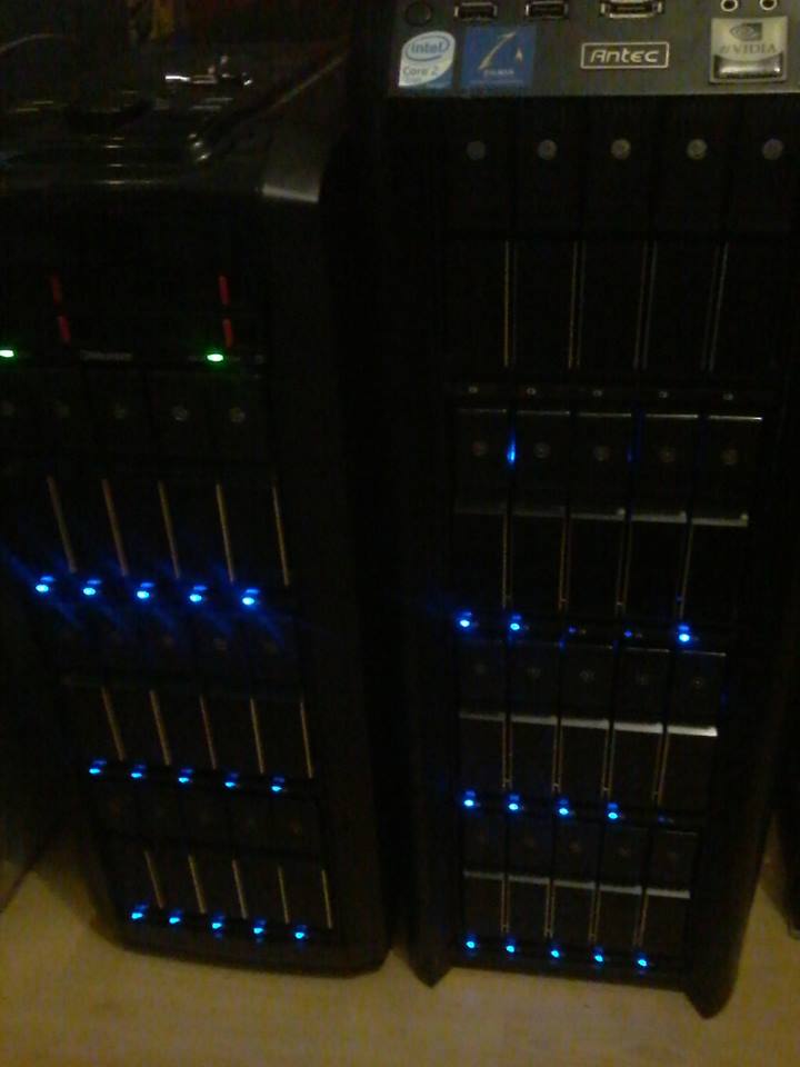

This is how I did it
I used:
1x 8087 cable plugged into a 8087-8088 pass thru in my sever
1x 8088 cable
1x Case (I have hot swap bays in a full tower)
1x PSU
1x PSU Jumper
1x Cheap Expander
1x Molex powered riser (Yes a PCIe mining riser card)
many 8087-4 SATA cables
Just make sure the riser doesn't short (I put a thin bit of wood under it)
If your think the riser is unreliable, buy a spare
In my country Rack mount cases are too expensive
Have Fun
