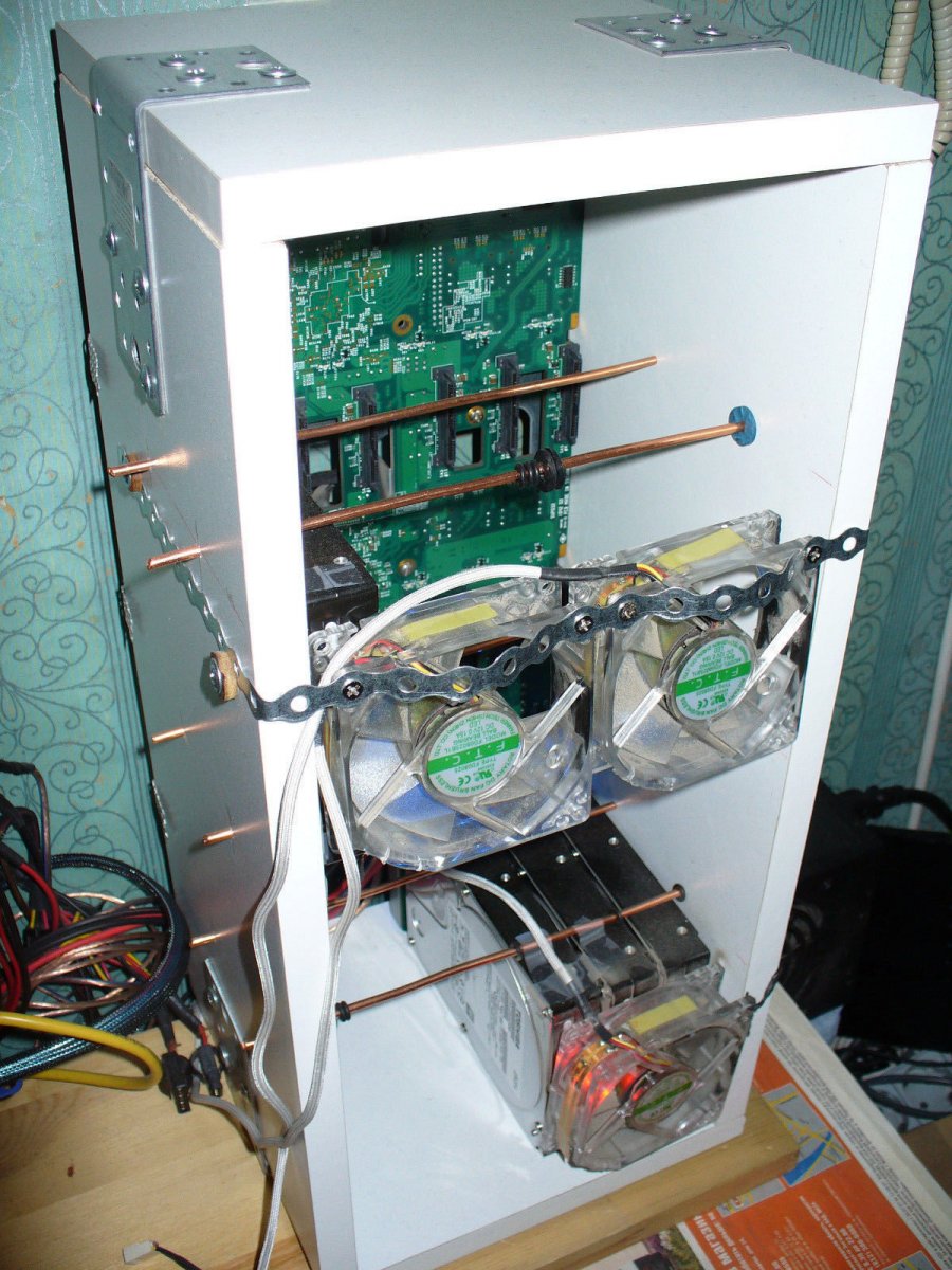

Hey, @Mirfster! I've found an HDD extension cabinet on eBay that you can add to the system you show in your avatar, and it's only $216 plus $100 shipping from St. Petersburg, Russia! It seems legit....
You'll have to supply your own power supply and hard drives though... :)

Lol, wonder if those are copper pipes and they are trying to tie in some type of cooling? ;)
Even funnier is that there are 4 people "watching" the listing on eBay...
Could be... but what impresses me is the scotch tape HDD stabilization scheme.
This is some high tech stuff!
The drives are, quite literally, flapping around in the breeze.

I thought they might be there to support a row of drives. Besides putting some on the bottom, how would someone fill it with 21 drives? Maybe there's a row of USB 2.0 slots, where one could plug in 14+ external drives. o_O
I think you're right! Two rows of 7 disks each on the bottom, one row of 7 disks on the top! Voila! 21 'bays'!
