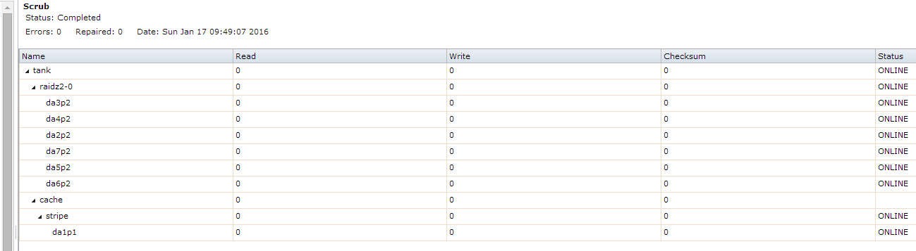

I added a l2arc to see if I could reduce the bussy time on the drivers. My FreeNAS is a seedbox.
kristoffer@freenas:~ % zpool status tank
pool: tank
state: ONLINE
scan: scrub repaired 0 in 9h49m with 0 errors on Sun Jan 17 09:49:07 2016
config:
NAME STATE READ WRITE CKSUM
tank ONLINE 0 0 0
raidz2-0 ONLINE 0 0 0
gptid/68cf78ef-8016-11e5-ac06-000c2975a9ee ONLINE 0 0 0
gptid/6b4ac5c1-8016-11e5-ac06-000c2975a9ee ONLINE 0 0 0
gptid/6dbfbdba-8016-11e5-ac06-000c2975a9ee ONLINE 0 0 0
gptid/7040d2ea-8016-11e5-ac06-000c2975a9ee ONLINE 0 0 0
gptid/72c9b0f2-8016-11e5-ac06-000c2975a9ee ONLINE 0 0 0
gptid/754e37fa-8016-11e5-ac06-000c2975a9ee ONLINE 0 0 0
cache
gptid/6fe8f9ce-c6f1-11e5-adf2-000c2975a9ee ONLINE 0 0 0
errors: No known data errors
kristoffer@freenas:~ % arcstat.py -f l2size
l2size
622G

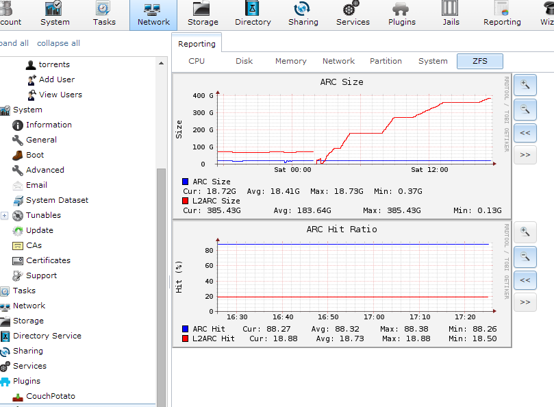

All I can think of is that you're somehow mistaken. If you look at
index.php
I would say that it looks like you had a 90G L2ARC device up until the wee hours Saturday morning, then removed it, and now there's something else there. If you screwed around with the NAS from the CLI, perhaps you somehow screwed up the L2ARC. What device is gptid/6fe8f9ce-c6f1-11e5-adf2-000c2975a9ee on?

jgreco
Resident Grinch
May 29, 2011
18,680
My guess is you did something unknowingly evil and wrong when modifying the L2ARC device. Detach it from the system, delete it from ESXi (including on-disk), reboot the NAS, create a new virtual disk of the desired size, and attach the disk, please. Then report what you see.

ondjultomte
Aug 10, 2015
117
People think virtualizing FreeNAS is a great idea, but I've got years of experience to the contrary.... so many forum users have come up with interesting edge cases and things that "shouldn't" be possible.
Ill do that as soon as the ill kids at home are finished with the movie they are seeing.
But there shouldn't be anything Messing with the pool it self, right?
Skickat från min HTC One via Tapatalk
jgreco
Resident Grinch
May 29, 2011
18,680
Right. Disconnecting the L2ARC isn't that hard, follow the instructions in the manual.
ondjultomte
Aug 10, 2015
117
I just reattached it and its all fine.
L2 ARC Buffer:
Bytes Scanned: 19.91 TiB
Odd tho that it reported ever increasing size.
I was too fast there! :) It's beyond 200GB now again. there is something between vmware and FreeNAS .
I'll tinker with it later tonight.
