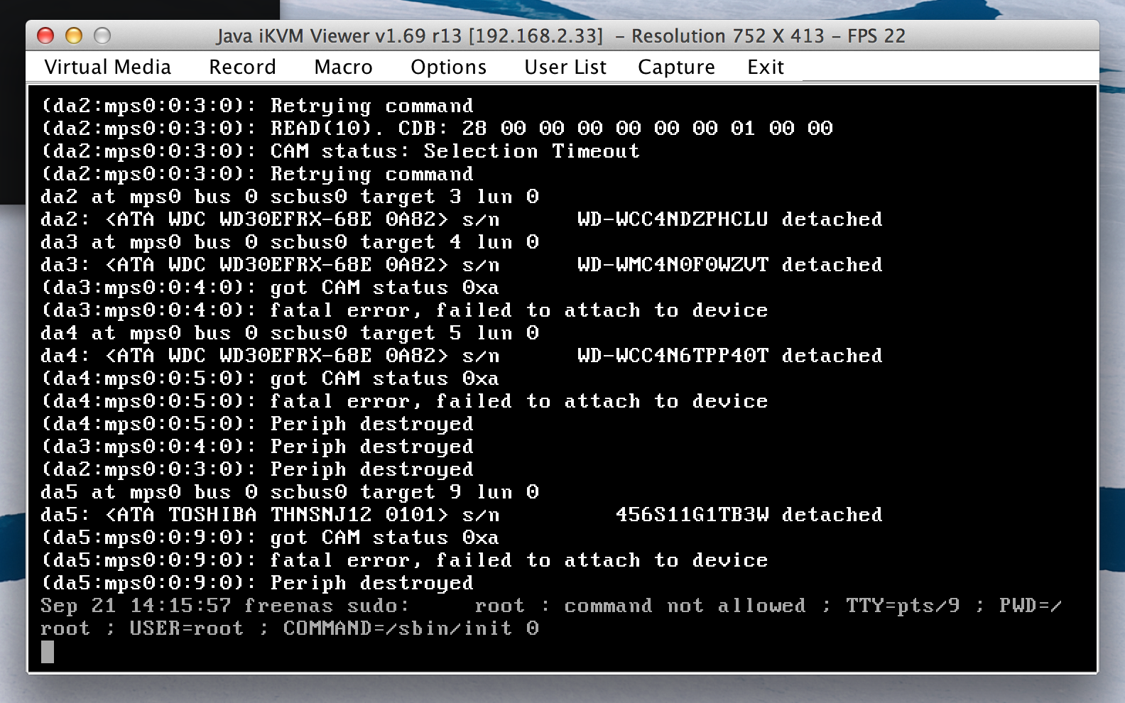

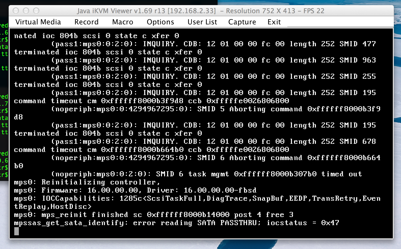

I am starting to get slightly crazy actually - replaced the CPU and doing more testing now. The most common kind of errors I am seeing are bus resets / device communication / SATA passthrough errors.
As another test, even though I've got multiple M1015 cards to test, I will actually remove the card altogether to see if I can reproduce any problems. I now have pretty much every part twice so it should be a bit more easy/efficient.
Another issue I've started noticing was with one of brand new 3TB HGST drives I've picked up. If I connect it to the M1015 (and there are other drives connected to it), it seems to be dropping off frequently (not the case if it's alone). I've got a few more of the same make/model so I am trying swapping it if I am actually experiencing multiple problems at the same time.
EDIT: added error message examples from previous tests
petr
Jun 13, 2013
142

Those errors look like the mps0 controller (M1015 or equivalent) is having major problems. I would definitely replace/remove that controller. And I'd probably do it sooner than later. If the controller goes bonkers and writes garbage to enough drives the zpool could, in theory, be corrupted beyond the ability for ZFS to recover.
petr
Jun 13, 2013
142
That's the problem - I am already on a second controller here... Will try putting in the first one I had removed after the first sign of trouble. It seems to get really "confused" when I plug one of the HGST drives to it. Will keep testing... and yes, it's M1015 flashed to IT mode (no BIOS), driver version is matching card firmware.
