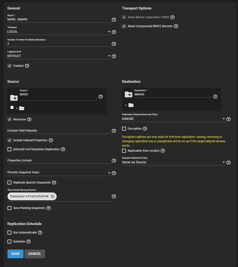

Hi everybody,
I have a pool with mirroring, so 1 drive is fully replicated on the other. While this is not a backup, it helps with availability.
I also run backups every 2 months, I do this by manually connecting the HDD (giant pain because I have to put screws and move stuff), plug it in, then I use "Replication" in the UI to perform what I would consider a backup. (see the config in attached files)
Or at least that's what I thought "Replication" would do.
- One time I performed a "sample test" and discovered missing files
- Now since I don't trust my backup mechanisms anymore, I used zfs-check and discovered missing files
- I also discovered _excessive files_, files that shouldn't be there but are
What are my options for:
- Performing a backup, the easiest way. Destination HDD should become "same" as Source HDD (non-existing files on source should be deleted from right, new/updated files should be copied over), if possible I'd like all snapshots to also be copied, so that the state are similar
- Avoid having to perform a full rewrite of the HDDs
- Sometimes pruning snapshots before a certain date on both source and destination
- Testing that the backup worked. Is zfs-check a reasonable tool? Should I use rsync instead?
I'd appreciate some help, since not trusting my own backups is scary.

It's not on an external drive. I asked that long time ago and was treated like a witch, so I plug the disk like a normal attached drive (I have a server with 32 bays or 24, I can't remember, but I definitely have plenty to spare).
For backups I do use the Replication task from the GUI. The "full system replication" option seems to rewrite from scratch every time though, is this correct or am I wrong?
The other issue I read is that there seems to be a bug where full system replication doesn't copy intermediary snapshots, at least that's what I read on this forum. I'll do some more research, I'm not home right now.
The "sample test" was opening a couple of directories and verify that some files I consider important were there. I did not find one of them, that's when the alarm bells went off.
zfs-check is a third party tool, I did not find any official utility to verify that the data is correctly copied and I don't feel comfortable trusting the system after that sample test
Finally, I did not include "auto" timestamps, I see that could have caused problems. My approach at snapshots is roughly:
Yeah, it can get a bit zealous in here. But "something" is always better than nothing. To jump through hoops or give up on even the simplest of backup plans (because you can't achieve a "perfect, holy, sanctioned" setup) is more harmful than just using a USB enclosure that at least gives you some sort of backup plan.
Something like this will suit the occasional ZFS backup. Externally powered and supports UAS:
It only means that it includes "everything" in terms of the source dataset's properties, recursive children datasets, and recursive snapshots. It also deletes extraneous snapshots on the destination that no longer exist on the source.
To "start all over from scratch" happens if there is no "base snapshot" shared by the source and destination, of which to do an incremental send.
This can occur if pruning is not properly handled or kept in harmony between the source and destination.
That's correct, and I'm the one that brought this to attention, as well as followed up on a bug report of this issue. The reason you see it now labeled as "(Almost) Full Filesystem Replication" is because they made it clear that this "bug" is actually intentional and will not be fixed in TrueNAS Core. So, I explained that at minimum the tooltip and label is misleading. At least they fixed that much.
However, this issue of intermediary snapshots is not exclusive to that option. The reason it's important to note is because you would assume that option will include intermediary snapshots. No option overcomes this. Skipping intermediary snapshots is hardcoded into iXsystem's zettarepl, which is the tool that runs in the background for Replication Tasks.
In order to "capture" all intermediary snapshots, you need to include all patterns in the included "naming schemas".

What happens if I delete snapshots when I do the replication task, will that delete snapshots on the destination?
If you delete snapshots on the source, then the next time you replicate to the destination, it will likewise remove the missing snapshots, so long as "Full Filesystem Replication" is enabled.

What is your pool's dataset hierarchy?
zfs list -H -t filesystem -r -o name JUPITER
zfs list -H -t filesystem -r -o name BJUPITER
I started with the analysis when I realized bakpcloud (and bakgdrive) are both encrypted. Turns out when I formatted the pool and then replicated the pool, I did not run "unlock" on BJUPITER (the backup drive). Unlocking it shows the file again, so zfs-check probably is detecting this.
I'll follow your analysis but this might have solved the issue. I'm re-running zfs-check to confirm.
# zfs list -H -o name -t snapshot JUPITER/bakpcloud | grep francesco | tail -n 1 | xargs zfs get -H guid
zfs list -H -o name -t snapshot BJUPITER/bakpcloud | grep francesco | tail -n 1 | xargs zfs get -H guid
JUPITER/bakpcloud@francesco-202306241607        guid    5367583431013952673     -
BJUPITER/bakpcloud@francesco-202306241607       guid    5367583431013952673     -
The dataset structure is the following:
JUPITER
JUPITER/bakgdrive
JUPITER/bakpcloud
JUPITER/batcave
JUPITER/batcave/Photos
JUPITER/mymedia3
JUPITER/mymedia3/francesco
JUPITER/mymedia3/francesco_XXXXXXXX
JUPITER/mymedia3/frasmb
BJUPITER
BJUPITER/bakgdrive
BJUPITER/bakpcloud
BJUPITER/batcave
BJUPITER/batcave/Photos
BJUPITER/mymedia3
BJUPITER/mymedia3/francesco
BJUPITER/mymedia3/francesco_XXXXXXXX
BJUPITER/mymedia3/frasmb
I replaced some text wtih XXXXXXXX because it was essentially revealing my email :eek:
