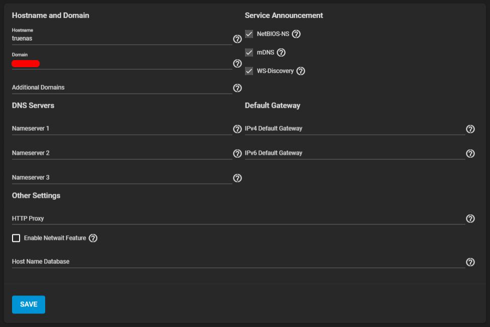

Network:

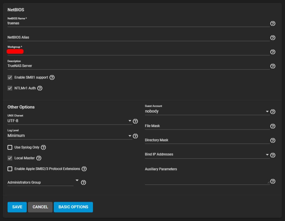

SMB:

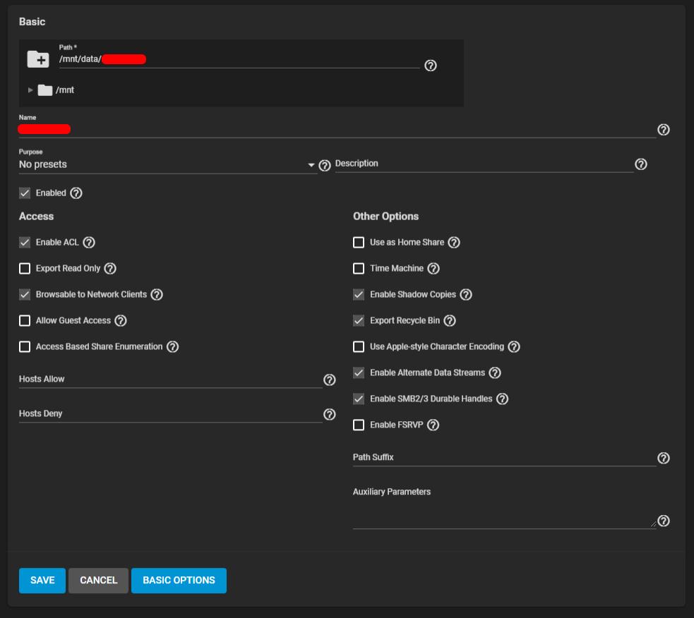

Share:
(I checked with "Allow Guest Access" and it didn't help)
