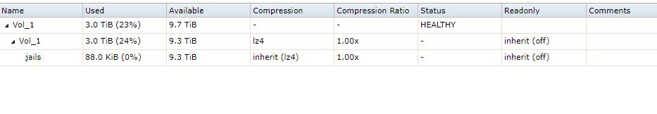

No, not stripe, JBOD as they are disks of various sizes (1x3TB, 4x2TB and 1x1TB).
FreeNAS doesn't do JBOD, unless by that you mean putting each disk into its own volume. As your storage screen shot indicates, you didn't do that. So if you didn't use any redundancy when you created the pool, all the disks are striped. If/when one fails, you'll lose all the data on your pool.
There is no need for redundancy here on the NAS. It is just being used as a backup from a PC. Data is backed up onto it every day 1:1
