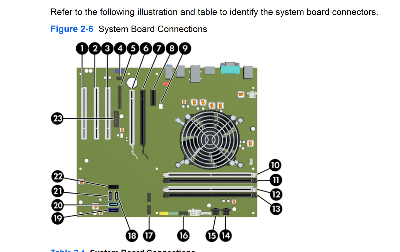

Hello. I have a HP 8300 Elite CMT and other parts I'd like to build a NAS. Here is my current HW. Let me know if I didn't do this correctly. Thanks
HP manual
  • MOBO is a HP Carver Rev PCEAV0BCY2V2BM Part #657096-001 (I couldn't find any additional info)
  • CPU Intel Core i7 3770 (3.4-GHz, 8-MB L3 cache)
  • MEMORY 16GB 4X4GB PC31600-MHz 12800u non-ECC DDR3 SDRAM
  • DRIVES Samsung EVO 500GB SSD for the OS, 3- 8TB HGST 0F23668 HUH728080ALE604 7200RPM 6Gb/s 3.5" Enterprise HDD, RAID 5 configuration
  • DRIVE CONTROLLER Built in to the MOBO 2 - SATA 3.0, 2 - SATA 2.0, 1 - eSATA
  • NETWORK Built in to the MOBO RJ45 Network Interface
  • POWER SUPPLY 320-W active PFC; 87/90/87% efficient at 20/50/100 % load
  • GRAPHICS Nvidia Geforce GT 630 1GB graphics card

Looks like you could use some help with various things. TrueNAS & ZFS do not do RAID-5. It can do something similar, RAID-Z1, but that is not recommended for disks >=2TB.
The OS does not need 500GB, though if that is what you have already, it will work. In general 16GB to 32GB is all that is needed for the boot device.
I'd suggest reading up on ZFS to know what it can and can't do. If you commit to a 3 disk RAID-Z1, you can not just add another disk. That capability does not exist, (yet, but that new feature might be years away).

I can't speak about the system board, other than it looks old because of the Non-Express PCI slots.
