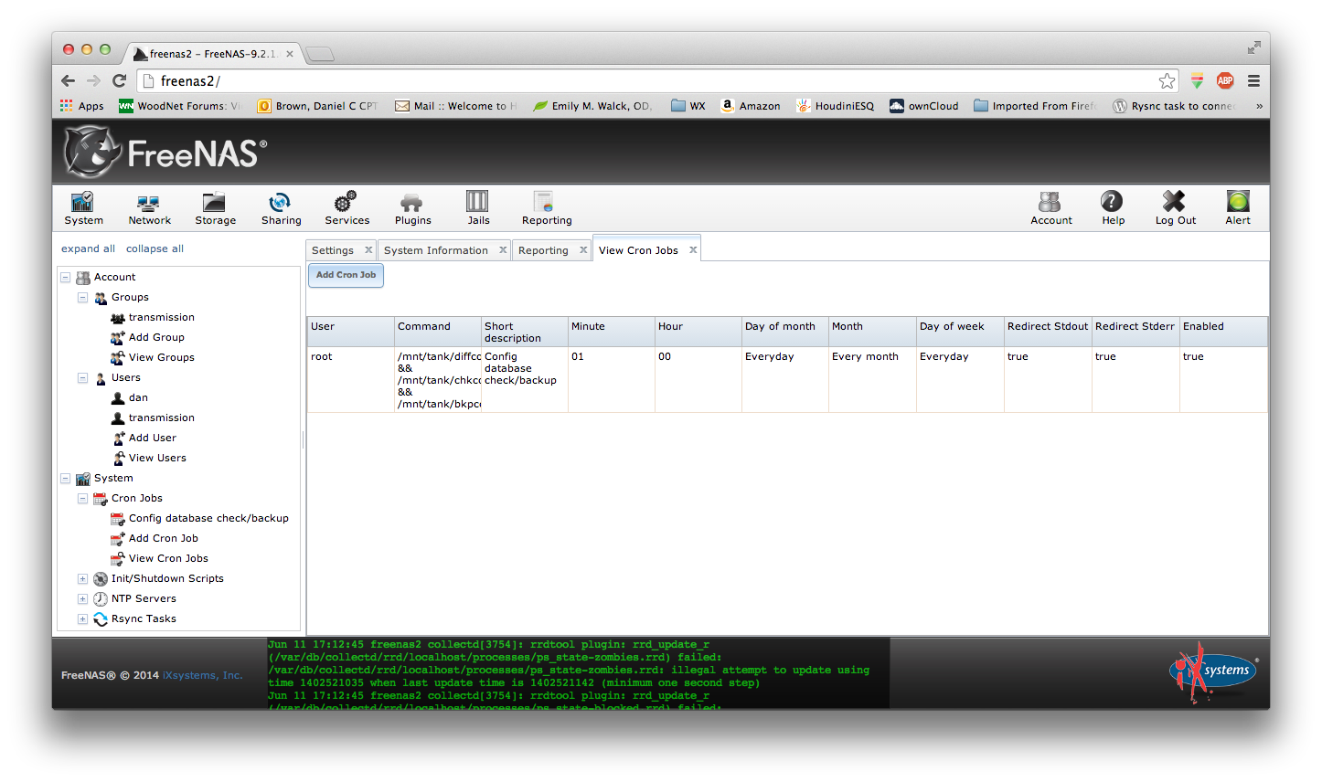

The chkconfig.sh script as posted didn't work for me--I would get emails saying "sqlite3: not found". I had to change that line (line 27 of cyberjock's posted script) to specify the full path: /usr/local/bin/sqlite3. Works fine now--thanks!

It sounds like you didn't follow my guide properly for cronjob creation so you have none of the path variables. It also means that while you think you may have fixed the sqlite3 the script may be incapable of sending an email. And just for completeness adding /usr/local/bin/sendmail may not even fix it.
You should instead go back and find out why your path variables are not being used in the environment the script is being run in. The two most likely causes are human error or you've customized FreeNAS. I'll leave you to figure out which one and how as I can't provide much more help than that. :/
15,504
I'm not sure what settings in the cronjob setup would affect the availability of environment variables other than (possibly) the user. My setting is attached, and it seems to match what you posted, but if you could point out something that doesn't match I'd be glad to see it.
I know the script can send mail, because it was sending mail that the database was corrupted. I haven't made any system modifications that I can think of, though I am running 9.2.1.6 BETA as of a day or two ago.

I don't know either, and since you aren't using it the same way that I am I don't have any advice. I know I'm using the 9.2.1.6-beta on my Mini with this script and it runs every night exactly how I did the setup.

The problem came down to how FreeNAS builds cron jobs. FreeNAS prepends a PATH statement (/bin:/sbin:/usr/bin:/usr/sbin:/usr/local/bin:/usr/local/sbin:/root/bin, at least in my system) to the command you enter--but when you enter "command1 && command2 && command3" as the command for the cron job, that path apparently only applies to the first command. The remaining commands get a much shorter PATH (/etc:/bin:/sbin:/usr/bin:/usr/sbin on my system), which matches the PATH specified at the beginning of /etc/crontab. This is why sendmail works (it's in /usr/sbin), but sqlite3 doesn't (it's in /usr/local/bin).
I can think of a few ways to deal with it:
  1. Change the sqlite3 call in chkconfig.sh to explicitly specify the path
  2. Create a fourth script containing only "/mnt/tank/diffconfig.sh && /mnt/tank/chkconfig.sh && /mnt/tank/bkpconfig.sh", and call that script in the cron job (the PATH prepended to the command should apply to anything called by that script)
  3. Specify the path for the remaining commands in the cron job, like '/mnt/tank/diffconfig.sh && PATH="blah" /mnt/tank/chkconfig.sh'
Option 1 seems the easiest. A fourth option would certainly be to remove the call to diffconfig.sh, but I don't see any reason to make daily backups of unchanged config databases.

My only problem with #1 is as I described above. What about other commands that may require a path and not have it. Will you know that the path is/isn't correct when it fails and you *should* get an email but won't because sendmail executes some other command that requires the path? This concern is precisely why I said:
So while I agree that #1 is the simplest, I also consider it the most risky because of other potential dependencies that may break with no warning. Personally I'd opt for #2 as a conservative option that has the highest chance for success in all scenarios. Considering that this stuff is somewhat important(you'd hate to have this break someday and not work for weeks or months without you knowing better) I'd prefer to stick with what is the most likely to work. ;)
15,504
If a command is called by a script (or elsewhere in a cron job) and can't be found, cron itself notifies you (which was what clued me in to the path as a possible problem--in addition to the one email saying my database was corrupt, I got another from the cron daemon saying "/mnt/tank/chkconfig.sh: sqlite3: not found" Thus, it seems the odds of a cron job failing silently appear to be roughly zero.
As to other dependencies, the chkconfig.sh script calls only two external programs--sqlite3 and sendmail. It might be better if the path were explicitly specified for both of them--then the environment variables would simply be irrelevant. I'm not sure if that's a "best practice" or not for these scripts, but it seems to have something to recommend it.
In any event, I've determined why the path that FreeNAS prepends to the cron job isn't applying to this script, what the PATH environment is for this script, and how it affects the script running in my installation. The great thing about UNIX is that there's more than one way to do it (whatever "it" may be).
Then you changed 2 things about how I do my install since I recommend that the stderr and stdout redirect to /dev/null. In that case they *would* silently fail.
Ok, and say for instance that sendmail needs to call some other dependency. sendmail may not return an error but the dependency will not work and your mail may not go out. I've seen this with dependencies between apache and openssl when doing ssl certificate validation and such.

I did redirect stdout and stderr to /dev/null (I refer you to my post #23 for the screen shot of the setup)--but that redirection only applies to the last command in the chain. Thus, if I do as you suggest:
If you want to do backups AND config checks, you can change the cronjob to instead be something like: /mnt/tank/chkconfig.sh && /mnt/tank/bkpconfig.sh
...the redirection applies only to bkpconfig.sh, not to chkconfig.sh. But that said, that's a good point that I hadn't fully processed. It still seems like a fourth script whose only purpose is to call the first three is needless added complexity, but it may be the best way to go.
In any event, apparently I wasn't very clear about my reason for posting in this thread. It wasn't "this is broken, fix it for me." It was "it didn't work for me this way, but when I made this small change, it did." The point was to help others who might encounter the same problem I did--and there's nothing at all in the GUI that will tell you why chaining another script will cause the second one to fail. The subsequent discussion has been helpful, I think, and points out pros and cons of some possible ways to address the problem.
Ah! I don't think I caught that part. I thought only the path was applicable.
