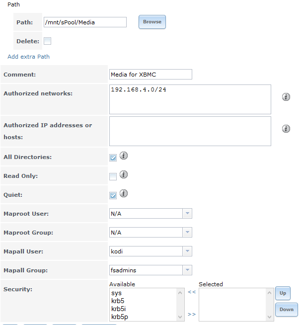

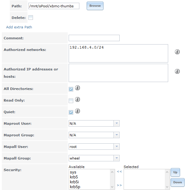

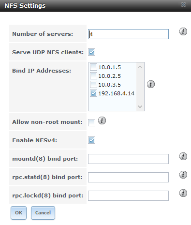

When updating the library using SMB, it works fine, and the connection is not broken, even if the thumbnails are written to the NFS share. So it appears that it dies due to the combination of exporting many folders (836 movies) and writing all the thumbnails at the same time. I have attached the debug logs, and screenshots of the shares.
