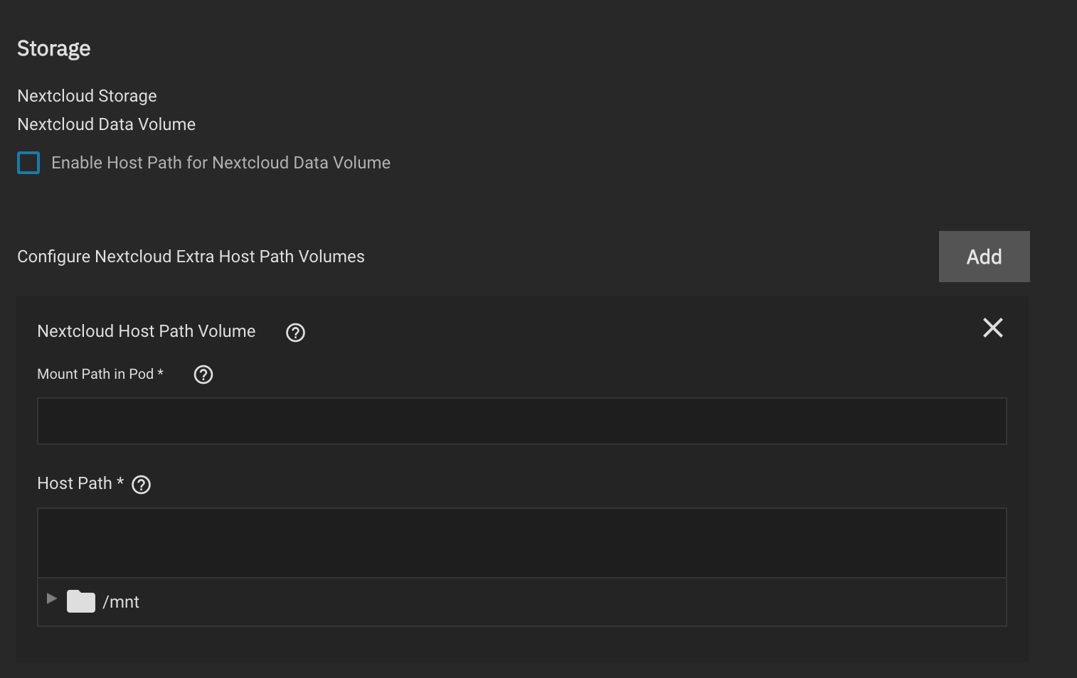

Thanks for the info. I try to reconfigure the nextcloud app so i can use the host path. Now i am confused how to do that in the best possible way. If i am understanding correctly i should not only put the data dir outside of the container, i should also do that with the config files. Am i right?
To do that i have here the option "Configure Nextcloud Extra Host Path Volumes". But here i need a host path + the mount path of the pod. Here's the point where i need the help. After reading this about pods, my understanding of it, is that the pod is actually the container itself in my case. So i dont want to change the location of the container itself, i just want to change the host path.
How should i go on now?

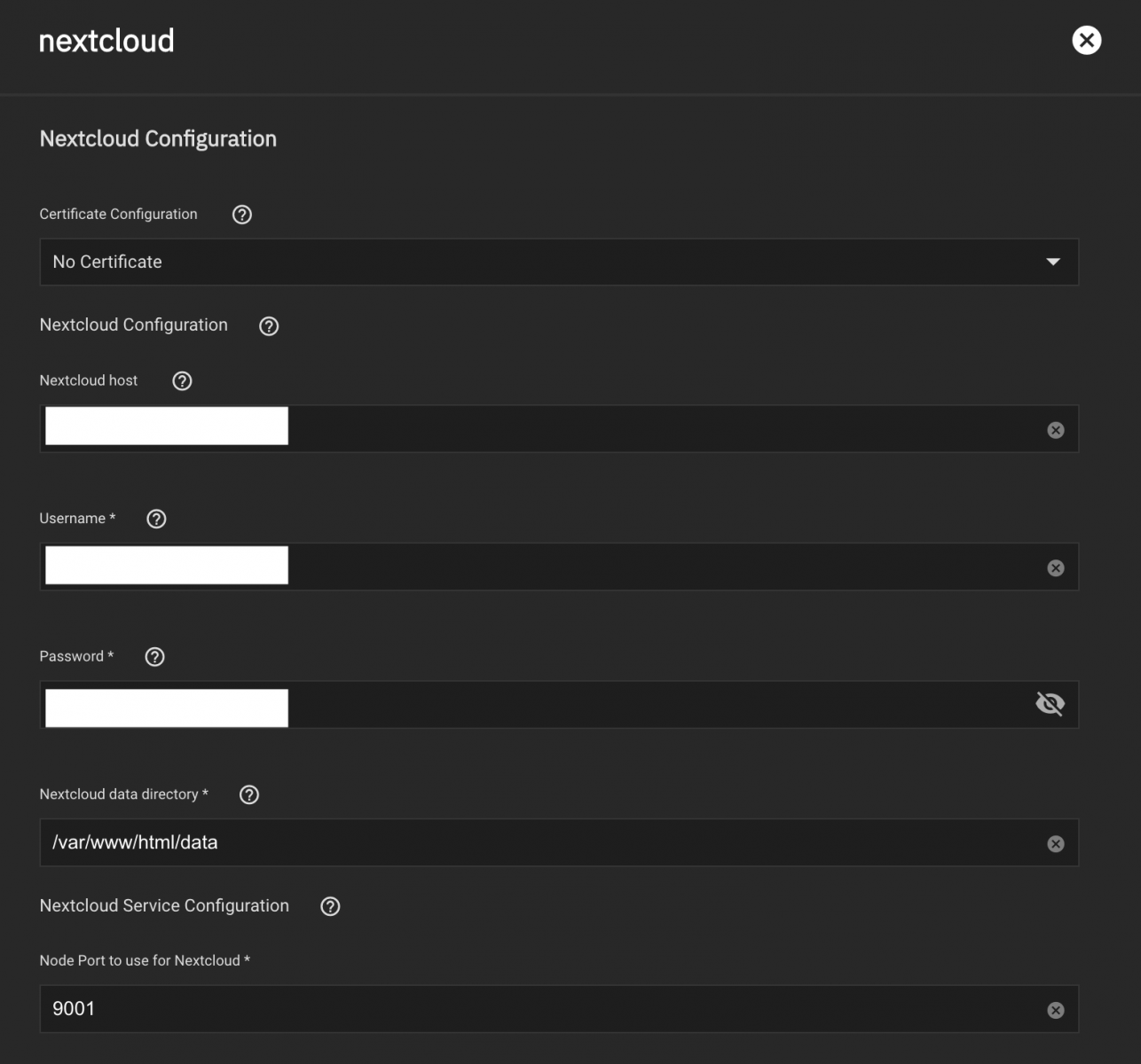

My second question is just for the understanding: This data directory is about where to put the data when it is inside the container and the other one when i am using a host path, which is outside of the container!?
For the first question, "mount path in pod" is the path inside the pod (to mount to the TrueNAS host). If you are using TrueCharts-based Nextcloud, and want to mount config folder only, "mount path in pod" should be /var/www/html/config, and the host path is somewhere you want to access this config folder in TrueNAS host. Note that the folder owner should go with www-data:root. You can create a dataset and assign owner/group to that while creating.
For your second question, yes this data directory is about where to put the data when it is inside the container. If you want to mount to the host, you can configure multiple "Nextcloud Host Path Volume" (shown in the first screenshot). Or you can just mount the parent folder /var/www/html (although I don't think it's a good idea). Note that there will be some permissions issues if you want to handle files in both host (where the user is not www-data) and Nextcloud webgui. It's fine if handling all the file in Nextcloud or use "external storage" feature in Nextcloud (SMB/CIFS) to access files in the host.

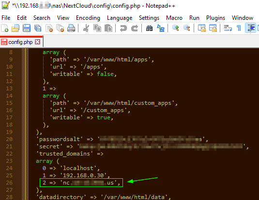

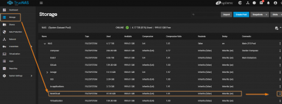

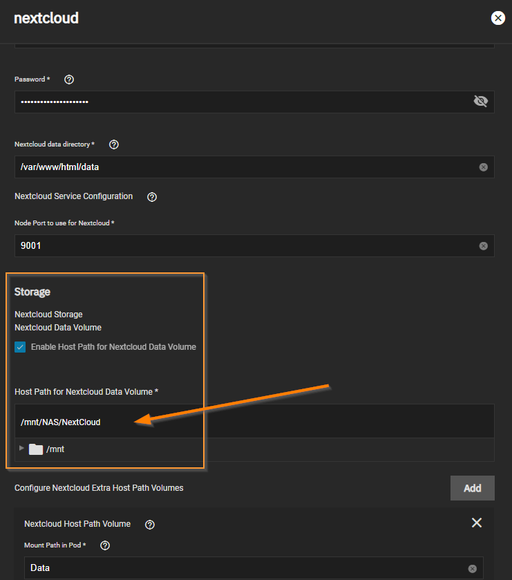

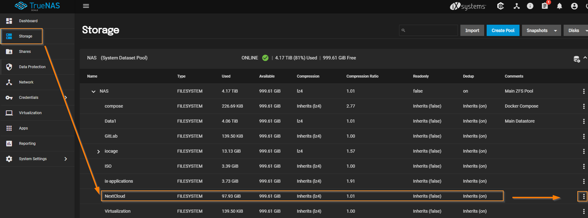

For my case, I had nextcloud deployed from the Official Charts, reflecting to the
  1. Create a NextCloud dataset before deploying you nextcloud
  2. using Host Path for Nextcloud Data Volume: ie. /mnt/NAS/NextCloud
  3. TrueNAS Scale go to Storage select NextCloud data set, edit permissions and granted your windows client SMB full access to the dataset.
  4. Navigate to \\192.168.0.30\nas\NextCloud\config\config.php, and edit the file on a windows machine save the file.
  5. Stop the app, then Start, then verify your external access is working.

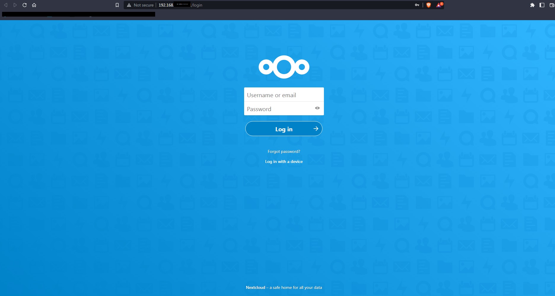

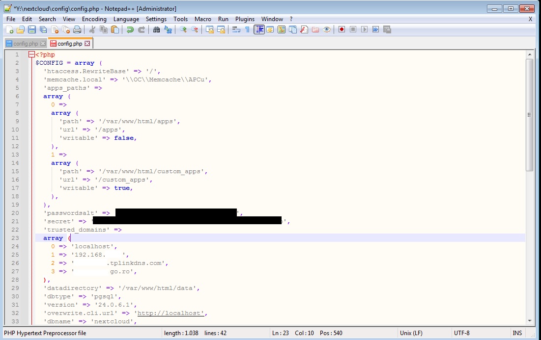

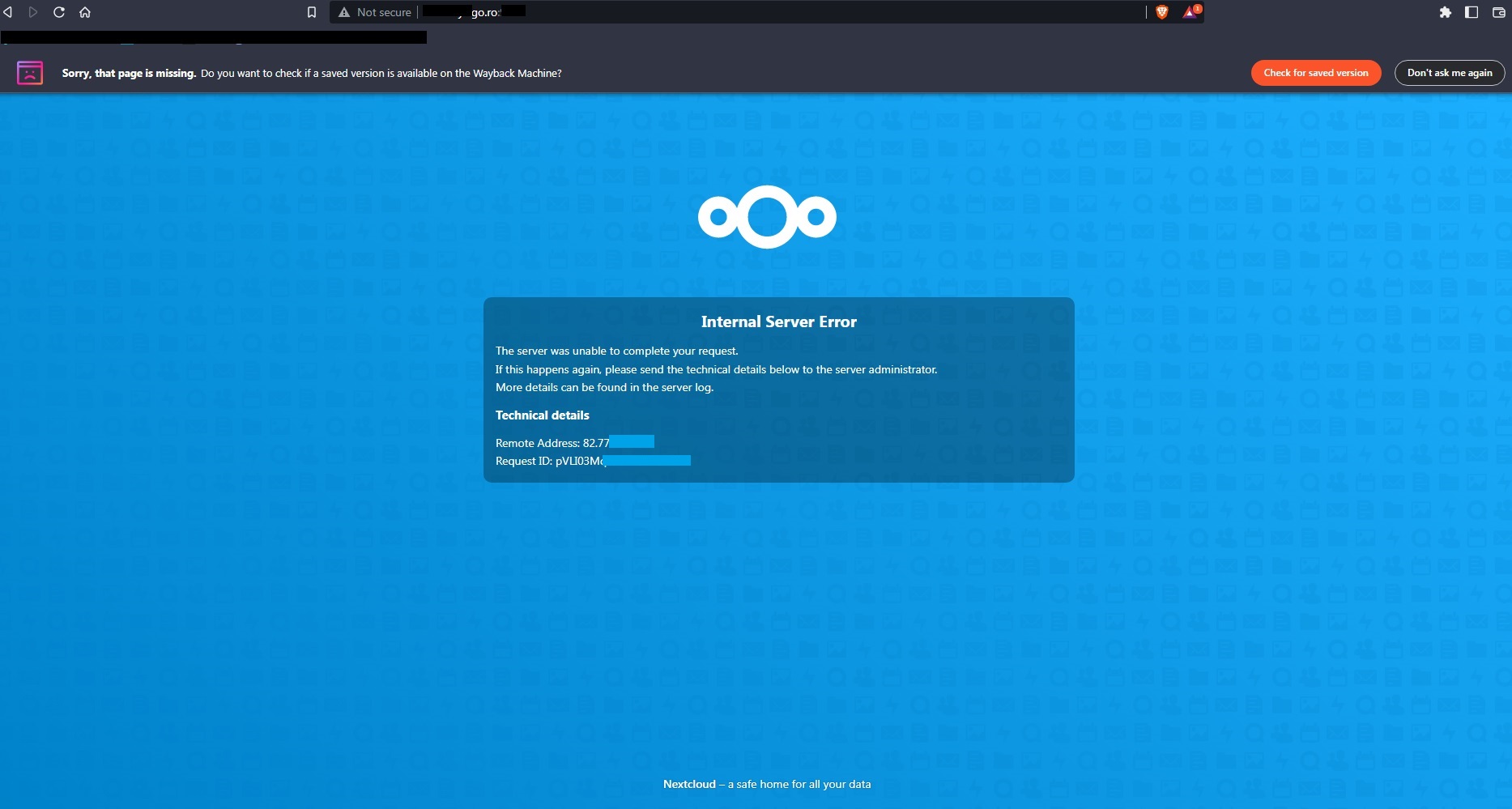

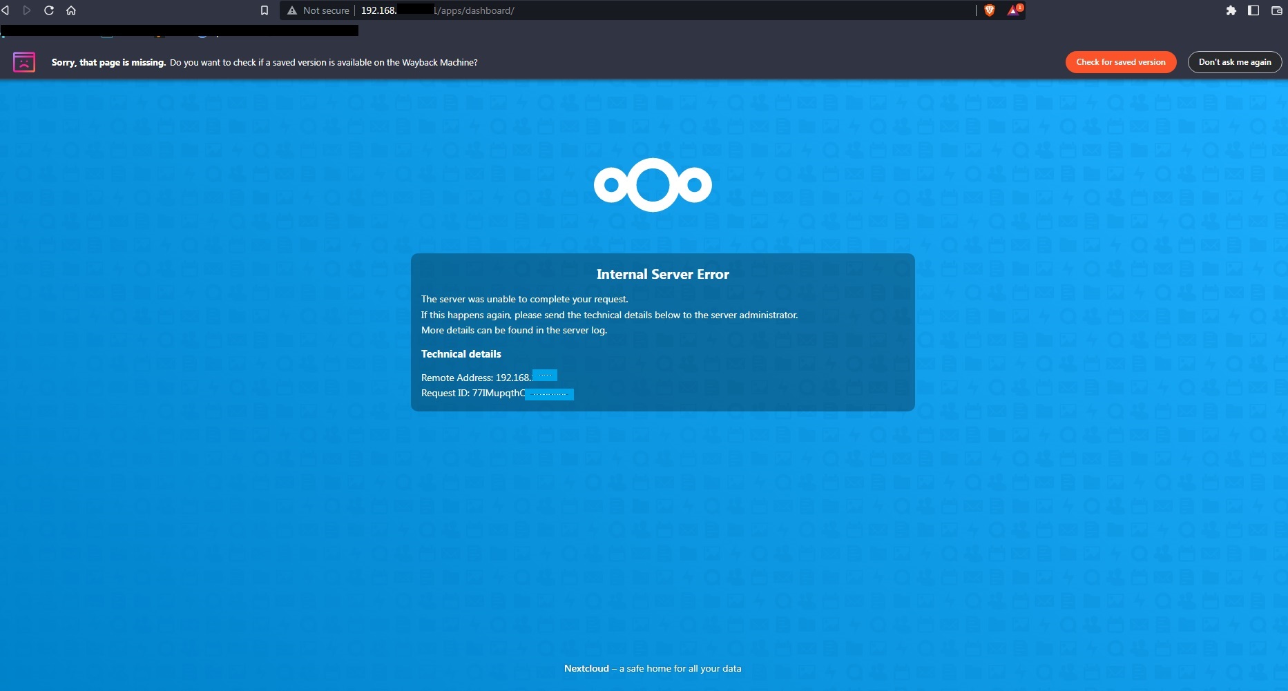

Hello all
i got some troubles after above steps. The ip host and domain are not available anymore after adding on trust domain something. Even after i delete the added domains, ip host get same error...
I attached screen shots before and after adding domains on config.php file.
On server is running Truenas scale 22.02.4 and NextCloud 24.0.6_1.6.12 installed from official catalog.
Forward port is active on router to be accessible from outside networks. Same error like on screenshots
Thanks for supporting
