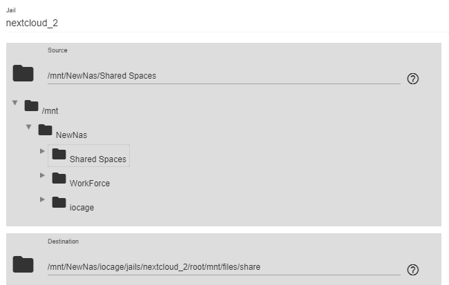

Hello, I recently re-installed freenas from scratch and i had next cloud set up so that one of the datasets is shared across our network on smb and we could also log into next cloud and access the same folder and upload online.
I can successfully access the folder from nextcloud and view all of the files currently. Unfortunatley I am unable to create or upload with in the dataset from next cloud but can create and copy from smb.
Any help would be appreciated. Haven't had a problem with this before.

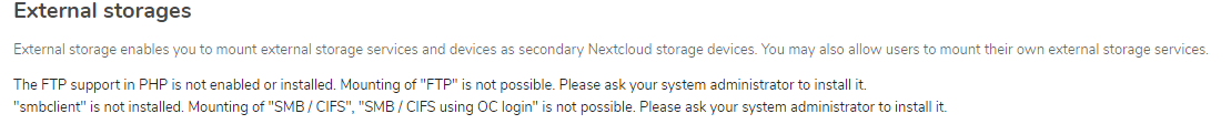

Good Morning, I had done this and the attached image shows that smbclient isn't enabled, how do I enable smbclient.

Heracles
Feb 2, 2018
1,401
Hi Corey,
Unfortunately, I am not using the jailed version of Nextcloud as it is in FreeNAS. I am running it from a Docker on a separate host.
What I know of FreeNAS' jails is that they are not meant to be modified manually. It is possible, but only for the most advanced admins and doing that will expose you to difficulties when an update will be pushed by FreeNAS.
So unfortunately, I can not give you more advice that would allow you to do it safely. The closest thing would be to remove the jail, create a Docker VM and then run Nextcloud as a container in that VM. That VM will be linux based and under your control, so adding smbclient will surely be easier and safer.
Good luck,
