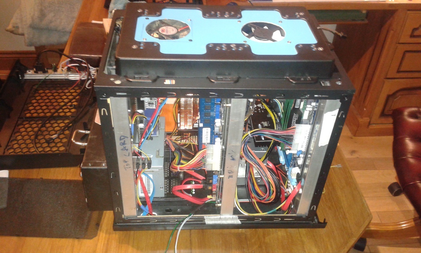

Good day Folks
Update installed 8Gb of ram replaced the hard drive with new Fujitsu the system is working for the past couple of days fine, I would like the system to shut down in the evening and come alive in the morning - I can see some information under Crone jobs but most of the terms and language is somewhat alien to me. Any simply explanation in plain English would be very helpful.
Thanks for reading my thread.
Shutting down in the evening is simple enough--just set a cron job to run daily at whatever time you want with a command of "shutdown -h -P now". As long as your hardware supports soft power-off, that will do it. Starting up, though, is a different story--you can't exactly run something on the computer to wake itself up when it's powered off.
no_connection
Dec 15, 2013
480
You could probably wake it up with WOL or Wake On Lan, many routers support that.
Or put a wake timer in BIOS.
