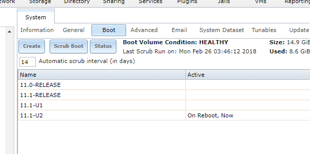

Sorry you are feeling insecure.. On your trip through the manual did you find section 2.5.5. If Something Goes Wrong ?
I suggest that you revert to the previous boot environment - In System, Boot, I expect you will see something like this:
Click on the penultimate line (should be your pre-update OS version) and select the Activate button at the bottom of the screen. "On Reboot" should move to that line. Reboot to activate the as-delivered OS, go to the System, Update tab and Verify Install for an OS check. FYI, when I bought my 4 HDD mini package in 2015 the disks had data on them. Fearing that it was a return I called iXsystems tech support to ask about it. They advised that it was their preshipment test install, so at least at that time there was active QC at some level in place.
Once you have checked out the as delivered OS, then I would follow the same procedure to Activate the latest OS boot environment (that from the troubled install), reboot, and Verify Install again (if you have not already done it following @MrToddsFriends suggestion, or even if you did) - just for more comfort).
