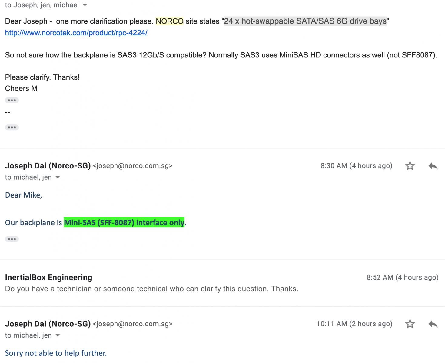

Rather shocking response. Earlier he claimed this was a SAS3 12Gb/s backplane, yeesh!
Later on I realised that I should have mentioned that interface and protocol are two different things, although the interface needs to electrically handle the higher bandwidth, frequencies, currents.
However, reading up I find that SFF-8087 is indeed 12Gb/s compatible, via Mini-SAS HD is even 14Gb/s compatible as an interface.
With such rudeness, I'm now trying to reach Supermicro for help.

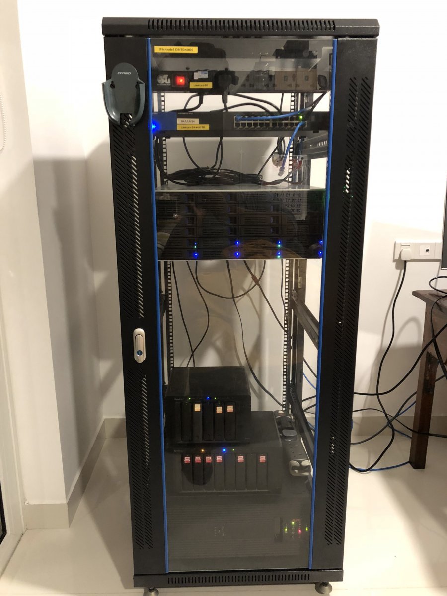

Hi @PhiloEpisteme --
Ran into some unexpected trouble, but thankfully I had burnt in my 8x 10TB drives. My current pool of 8x4TB drives first experienced a 2-drive failure (Raidz2) and whilst I was resilvering one of the 10TB drives, all the remaining drives we reported as degraded and one as faulted.
Suffice to say the pool was dead, so I've re-created a new pool using the new 8x10TB drives and started `rsync` ing my data from a Synology box that has been standing in as my 'break-glass' "backup".
1. I can't seem to get rsync over SSH to copy binary files faster than 5MB/s and I've tried the tips here https://gist.github.com/KartikTalwar/4393116
2. Is there a Supermicro chassis you can recommend to allow me to setup a basic "PC" to run my VMs; I've already got the hardware running in a desktop case; I just want to relocate this into the rack.
So basically, it needs to be 4U, either support an ATX PC style PSU or preferably have 2x server-style hot-swap PSUs. In terms of storage it doesn't need to have many bays at all. May be space for 2x couple 3.5" drives/SSDs is plenty. More importantly though, support for ATX/E-ATX mainboards would be great, 5+ full-height PCI slots etc.
