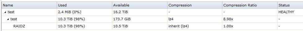

The idea was then to combine the 2 sets into a Stripe, however when I finished, it created only 1 entire set(see picture attached), so I don't know if it's already Striped them ?

ZFS vdevs can only be striped with one another, so if you started with one RAIDZ of three drives, and added a second, it would be striping the second one into it. You can see that via the total raw size of your pool.
But if that image is correct, the pool is 98% full? That kind of usage will make anything crawl.
15,504
No, it looks like he's created a dataset within the pool called RAIDZ, maybe with 10.5 TiB of reserved space? Not quite sure what's going on, but you'll note that the dataset also says it has 10.5 TiB available.

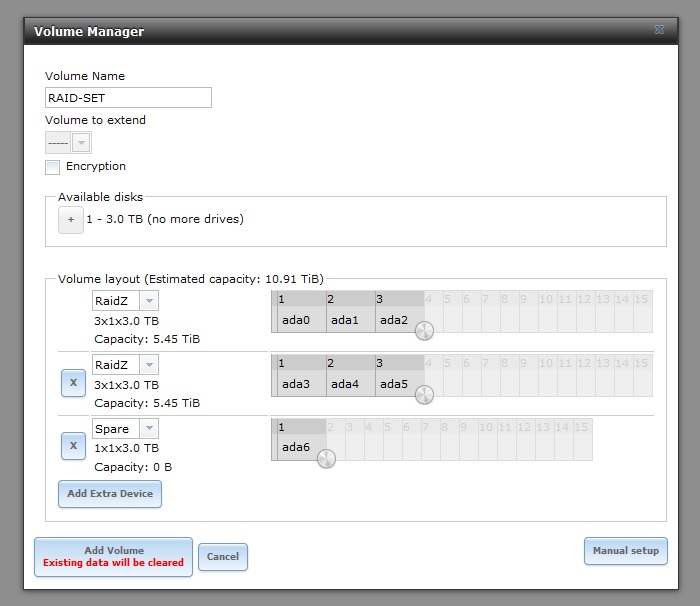

I went ahead and re-created the set, took a picture of it this time so you can see exactly what I did, what you see in the picture attached in this post, created what you see in the picture in the first post. with RAIDZ2 I was getting about 50-70% utilization on a single GB link, when I setup what I did in the picture attached, speeds seem to be a bit better. With RAIDZ2, a single 50GB ISO starts at a burst of 250 MB/s or so, eventually drops to around 60 MB/s, with the setup I did in the attached pic, it drops to around 80 MB/s sustained.

The z2 configuration should saturate a gigabit link so I suggest using that. And also don't use z1 it's not best practices to use it. Just transferring a file isn't a good way to test performance. You need to look at network speeds, then local disks speeds and src client speed to actually figure out your bottleneck.
