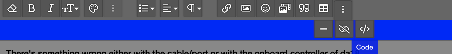

Code tags are here:

Still having problems with code tags
