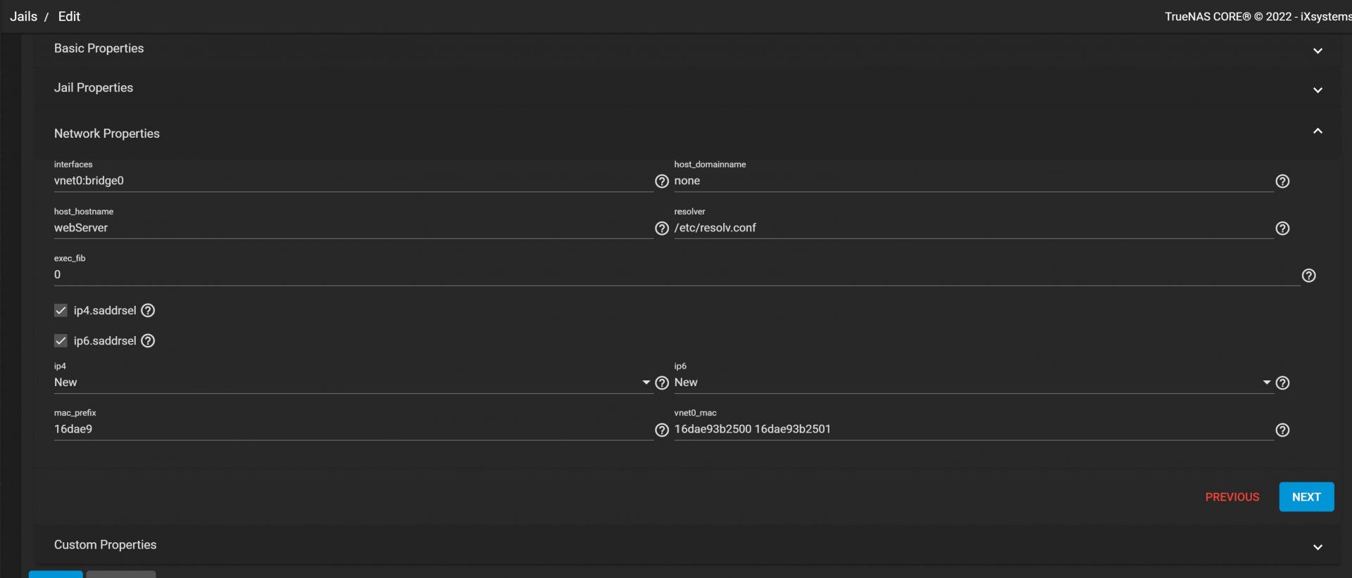

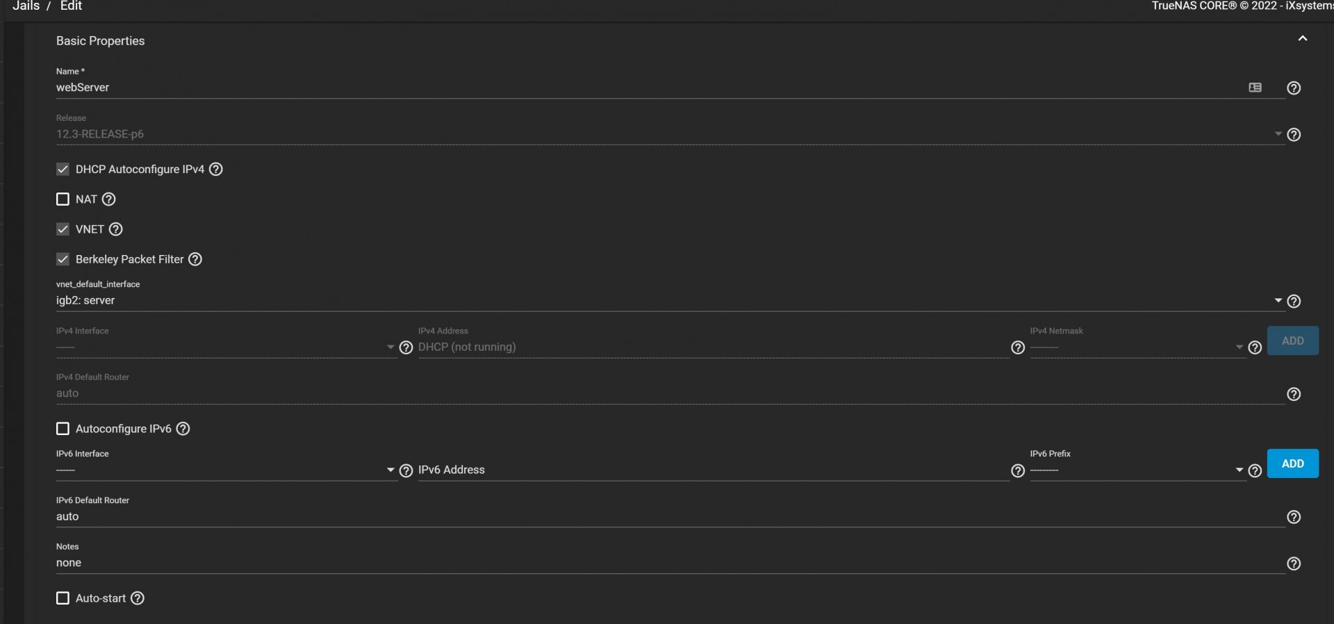

I have created another jail and configured the it the same way as the plex jail (with the exception that it is on its own dedicated port on the nic). When I bring up this jail, my entire network goes down(!)
Here is the configuration of the non-working jail (which are nearly identical to the working jail/plugin):

Got it working. I followed these instructions and created a bridge for the nic port. Then set the jail with the following:
  • vnet_default_interface: none
  • interfaces: vnet0:bridge1
