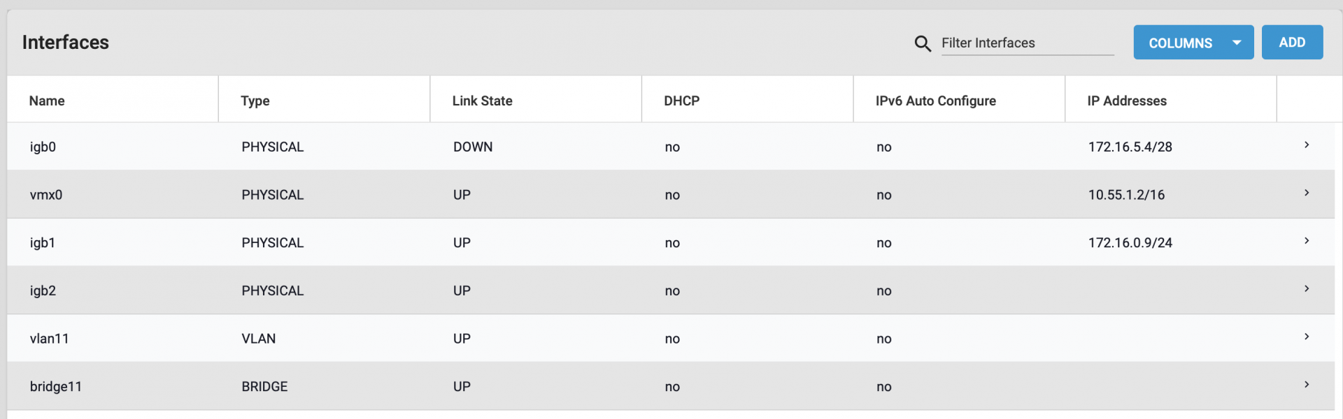

FreeNAS works under ESXi with AHCI controller and selected NICs (3 out of 8) passthrough enabled. Following is a list of my interfaces:
igb1 is host's main interface, I'm trying to use igb2 for jail assignment and later on - igb0. So far, I've figured out that in order to use interface in jail, interface itself can not have an IP assigned (in Network -> Interfaces).

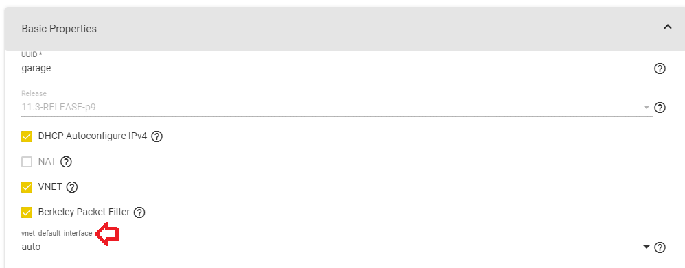

In the jail definition, you can change the vnet default interface to your preferred NIC.

Sorry to raise this thing from the dead... but I have a problem using this configuration. Traffic still goes through em0 even when I choose another nic in vnet_default_interface.
I have 3 interfaces (no bridges configured):
  1. em0 - main for TrueNAS (connected to switch 1 port 1)
  2. em1 - used for jails (connected to switch 1 port 2)
  3. em2 - unused
When I create a Jail, I use DHCP, VNET and BPF. Then choose em1 in vnet_default_interface. Network works fine but the switch tells me there is traffic on em0. What's odd, is that there is also traffic on em1 and it's always the double the amount of em0.
For example let's say I download at 25mbps from the jail, I will see 25mbps on em0 (port 1) and 50mbps on em1 (port 2) on the switch.

You must first create a bridge interface with your physical as member manually and then set:
  • vnet_default_interface: none
  • interfaces: vnet0:<your-bridge>
in the jail properties.
If there is an IP address for the NAS on the physical interface, you MUST move that to the bridge instead. Bridge member interfaces MUST NOT have IP addresses assigned in FreeBSD.
