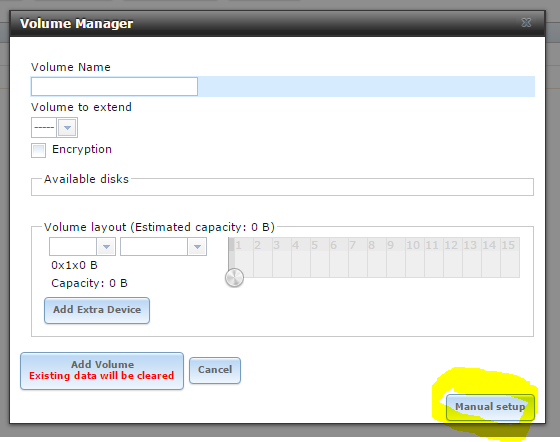

As for the second part I had figured that out just after I posted - Volume manager has a button at the bottom called "Manual Setup", I used that and it worked.

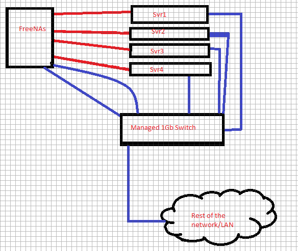

The MB is a gigabyte G1 Sniper3, it has Intel GbE Lan phy and a Qualcomm Aheros Killer E2201 chip sets.
Why do I need the ports?
Need them because I have four servers ( 3 esxi 5 and 1 windows 2012R2 which is the File and print server for the AD domain).
I will be making direct connection to the FreeNas server ( not going to switch) and each port will have its own ip for use with iSCI - hence the four ports one for each server.
Rough network diagram.
The others 2 ports will be used for the other normal/management traffic.
As this is a new build and still in the testing phase I am open to any suggestions.

You know that you shouldn't have all the ports on the same subnet right?
