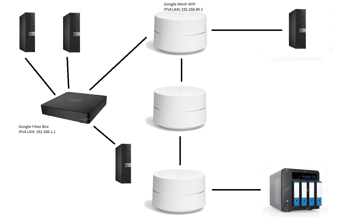

This is the sort of question where I ask for a network diagram, with IP addresses. That way we know eher the wires go, whats attached to what etc
Rbv
Aug 10, 2021
I am sure this is grossly oversimplified for what you are looking for, but it was a first stab. I will throw in any additional info needed.

Can we have IP address (where known) on each box please?
