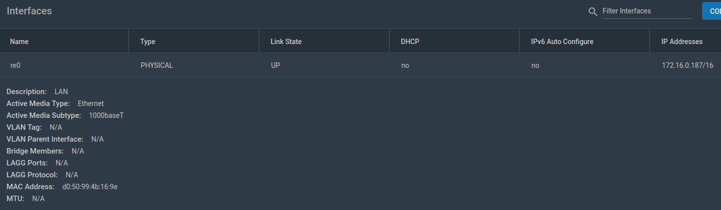

1. I try to connect by CLI (ssh) or GUI (web), with unsuccessful result and if I enter the computer directly from the console I do not reach any device on my network, I have tried to restart the Network service itself, but it is only solved by restarting the TrueNas.
2. between my pc and the TrueNas, I have a switch and the TCP/IP addresses of my devices are static
