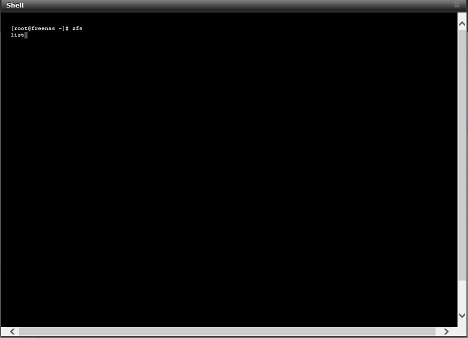

Ryan Zimmerman
Nov 11, 2016
26
Probably easiest then launch a shell session from the browser. Click on Shell on the left hand side of the screen. Make the shell screen as big as you can using the bottom left drop down options.
Then type:
zfs list
and print screen that so I can take a look first.
I tried that and when I type in zfs list, nothing happens...attached is screenshot

Jul 3, 2015
926
try it again as it doesn't look like it entered correctly. just type:
zfs list
Jul 3, 2015
926
and hit enter

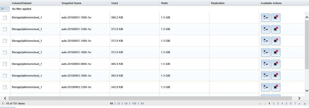

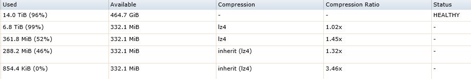

Ryan Zimmerman
Nov 11, 2016
26
See attached
Jul 3, 2015
926
ok ta. I can't see the pool or dataset name as you've cropped it but the one with the 6.8TB used is the one you want to focus on. you're snapshot schedule doesn't last long (1 week) so Im not convinced it is snaps causing your problem. You could do with running the command below on that dataset to see how much snaps are consuming.
zfs get usedbysnapshots pool1/dataset1
Just noticed it looks like your pool is called Storage so it would be:
zfs get usedbysnapshots Storage/dataset1
dataset1 being replaced with the name of the 6.8TB dataset
