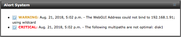

When I log in to the FreeNAS server from a remote computer using the WebGUI I'm getting a couple of alerts, shown in the screenshot below.
Can you explain what these mean and how to fix? The first Warning is interesting because the IP address in the alert is the address that my modem/router assigned previously, before I assigned FreeNAS a different static IP address. I have no idea what the second Critical alert means. Can you advise on these?
Are you running FreeNAS in a virtual machine?
We need to get a rundown on what hardware you are using for your FreeNAS build (as much as possible) because the "multipaths are not optimal" thing up there tells me that you have some faulty hardware, but we need more information to be sure.

I realize this is not an optimal hardware setup but it seems to be working well for streaming media locally except for those pesky alerts!
Those pesky kids... Sorry, but the problem is bigger than you know. You can't mirror two drives on USB. Probably has only worked this long because you have not run it very much. The USB interface is why you are getting the multipath error. This hardware isn't just sub-optimal, it is unusable. You will not be able to have a stable, reliable FreeNAS with this hardware.
I was afraid you were going to say that. Guess I'll have to start saving up for dedicated hardware. At least I can use the two 8TB drives in a NAS enclosure. Do you have any recommended NAS boxes?
