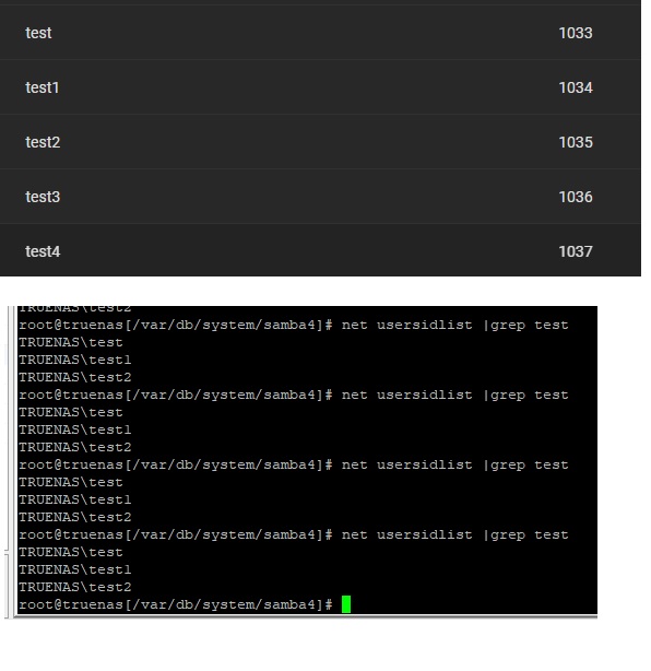

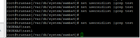

It is very strange, I create a new account test, and then check the net usersidlist , but there is still no test account.
jasonca
Dec 2, 2021
19
I added one more user, test1, and then check net usersidlist, it show test and test1 account
jasonca
Dec 2, 2021
19
I created test3 and test4. But the net usersidlist did not show test3 and test 4.

pdbedit -L |grep test
test:1033:test
test1:1034:test1
test2:1035:test2
jasonca
Dec 2, 2021
19
cat /etc/passwd |grep test
test:*:1033:1026:test:/nonexistent:/bin/sh
test1:*:1034:1027:test1:/nonexistent:/bin/sh
test2:*:1035:1028:test2:/nonexistent:/bin/sh
test3:*:1036:1005:test3:/nonexistent:/bin/sh
test4:*:1037:1029:test4:/nonexistent:/bin/sh

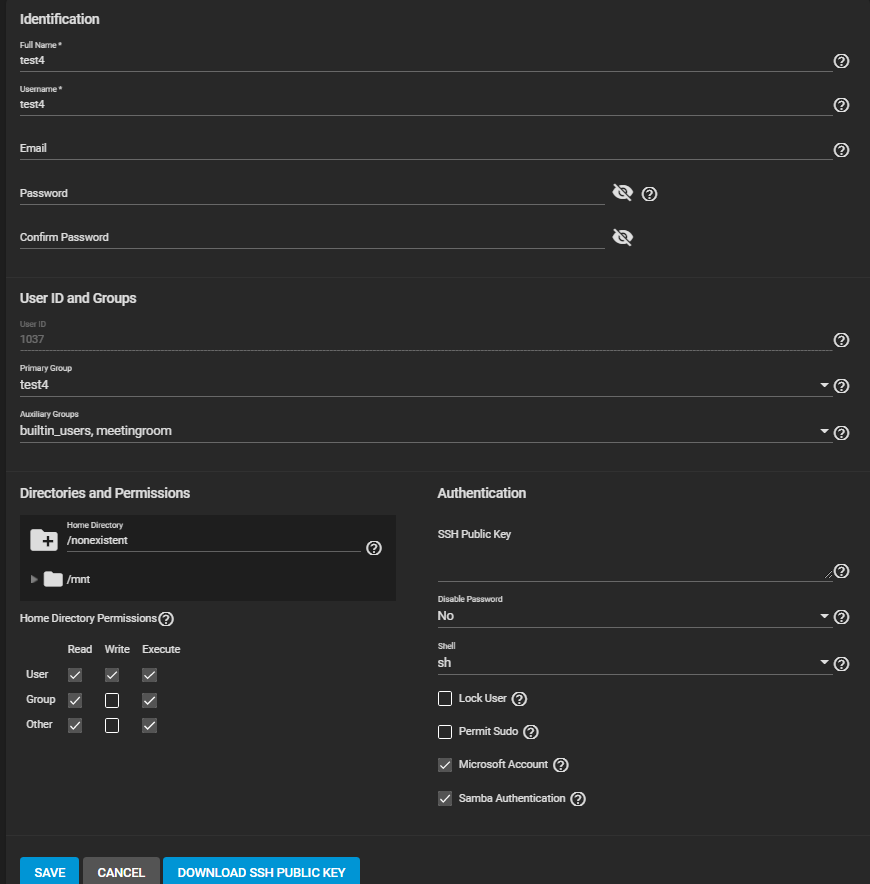

User test4
