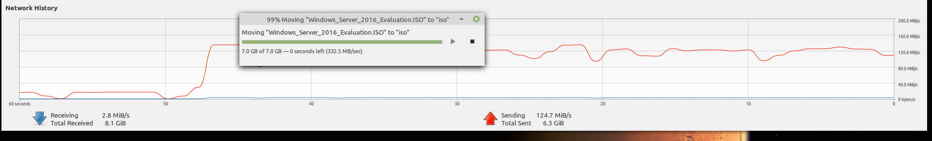

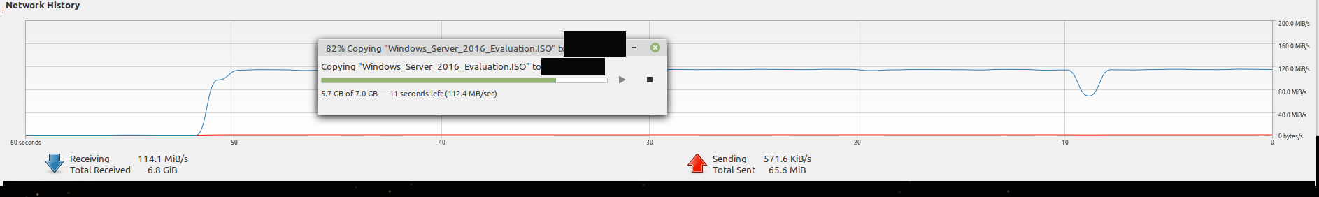

Just my two pence. I would recommend getting an Intel NIC for your NAS and PC as other posters have suggested. They are not a great deal of money.
I have dual bonded Intel NICs on both my TrueNAS and PC (yes I know this does not mean I get 2GBs speeds). The reason I reply is I am also using Linux Mint with an NFS share. My TrueNAS also has 32GB of (slower the OPs) RAM. I can copy a 7G iso either way in about 65 seconds by my stop watch.
