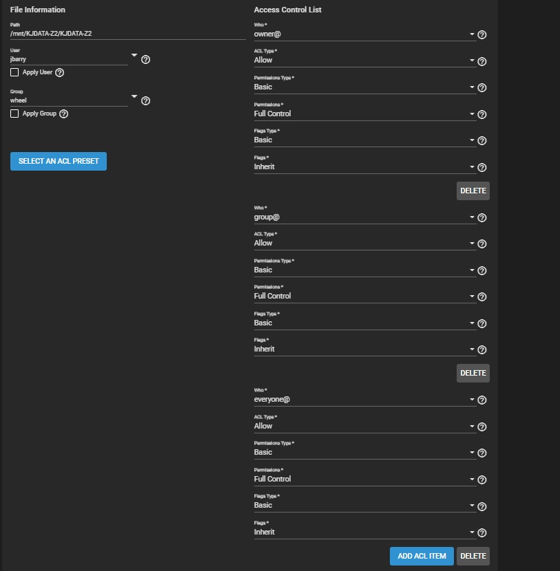

I have added a screenshot of my edit permissions for the shared dataset.

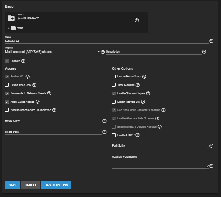

Please clarify - are you sharing the same dataset with both SMB and AFP? If so, there's your problem. That's a big no-no. You would have to use SMB for all. Macs can deal with SMB and Apple is apparently deprecating AFP.

1. I don't know if just turning off AFP will be enough to fix things. There may be residual effects of having used AFP.
2. I have no idea why the SMB share settings include these multi-protocol (AFP/SMB) presets. I thought that was verboten, unless one was read-only. I think we need to ask the Sambassador, @anodos , for help with this issue.

OK, lets back up. You have a pool called KJData-Z2. The pool has a root dataset of the same name. In Storage > Pools, you can see it under the pool. Any datasets contained in the root dataset are indented under it. In your first screenshot it appears you have a dataset of the same name as the root dataset (/mnt/KJData-Z2/KJData-Z2), which seems needlessly confusing.
You shouldn't put anything in the root dataset (other than other datasets) and you shouldn't share it. One of your screenshots shows an SMB share of the root dataset /mnt/KJData-Z2. You should delete those and just make shares of the sub-datasets.

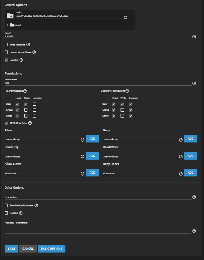

You asked about share settings. With the share there is a menu option called Edit Share Permissions. I don't know if anything there needs changing.
As I said before, I suspect some lingering ACLs may be playing havoc with your sharing, and causing lack of access where you think there should be. Personally, I don't need ACLs and the complexity they bring. If you want "simple" Unix permissions, you can
1. In the shares, uncheck Enable ACL.
2. In the dataset Edit Permissions, at the bottom, click Strip ACLs.
3. Then you can go back into Edit Permission and see that owner, group, and access modes are what you want (sounds like you want to check all the boxes, but you might want to back off the modes a bit for security after you get it to work). If you change owner or group, check the confirm box with those. If appropriate, check the recursive button.

I have been looking through all of the settings, and I have yet to find a check box for enabling/disabling ACLs

It's in the share settings (for Windows shares). I think it's the first checkbox.
jbarry14
May 23, 2022
56
Ok, I have to change it to no presets to uncheck that box. I currently have it set to multi protocol SMB/AFP.
