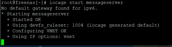

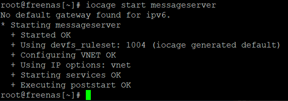

So your jail starts successfully, and your script automatically runs, but the issue is that the GUI will not refresh? If you try to start the jail from the command-line using the "iocage" command, does it work without issue?
Yes, if I remove my script from the rc.d folder and start up the jail using iocage, it starts normally and I get the command prompt as expected:
However, once I put the script back into the rc.d folder, it hangs before "Starting services", but it does execute my program because I'm able to hit the server from a client machine.
FWIW - my jail is also named "messageserver" so don't let that confuse you.
This is my first time messing with rc.d scripts so it's possible I've done something wrong there, but this is what my file looks like:
