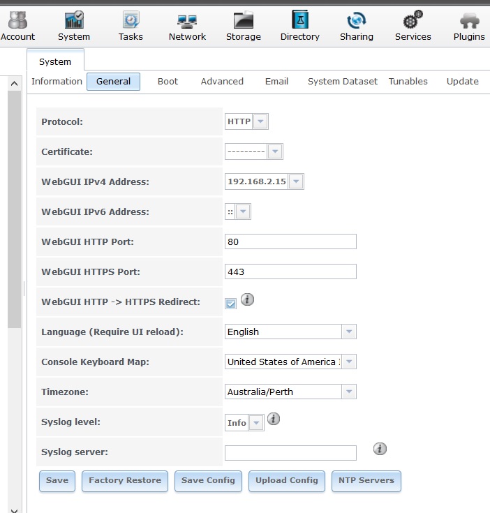

- Static ip changed so wanted to get this changed from 192.168.2.100 to 192.168.2.15 - entered the interface change menu and added this new ip.

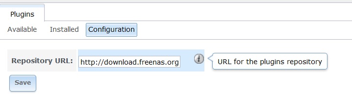

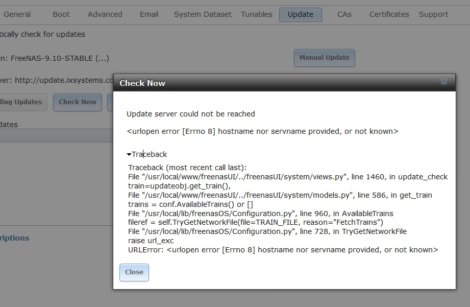

1. Going into System Update checking for updates, nas spits the dummy (pic attached) - The url is accessible from within my browser - just nas that dont seem to be able to connect for some reason.
2. Going into plugins checking whats available, nas spits the dummy
When you configured the static IP, did you set the default gateway?

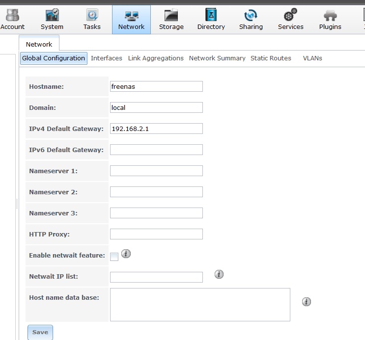

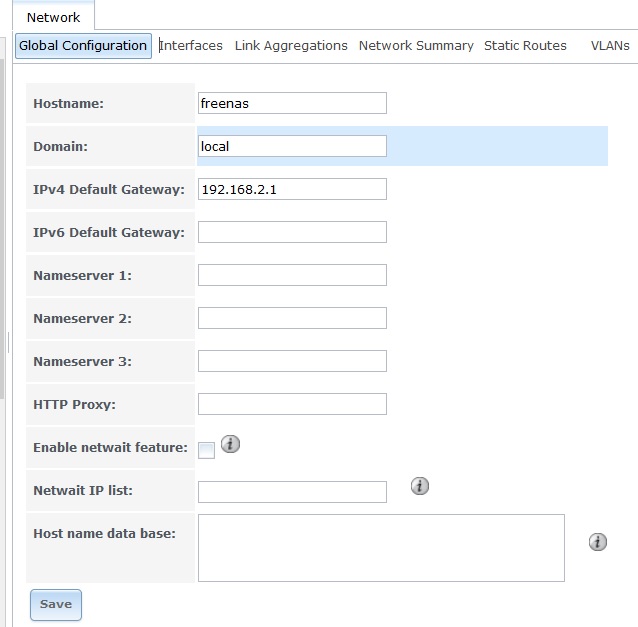

What does "Network", "Global Configuration" show?

If you have DNS set in your router, suggest you put your router address in the Nameserver fields. If you don't have DNS set in your router, suggest you put your desired server(s) in the Nameserver fields.

The NAS needs nameservers configured in order to access update servers, plugin catalogs etc.
In your picture, Nameservers are not configured.
But if you assigned a static ip via dhcp from your router/dhcp server, that would include the name servers for your network.
nojohnny101
Dec 3, 2015
1,477
Nameserver is your problem, set that in FreeNAS and you should be good to go. You've gotten solid advice on here. Not setting the nameserver is actually a common problem I have seen multiple times on here.
