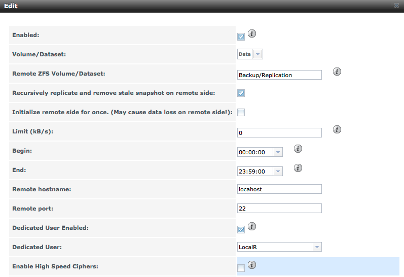

Well I tried and it won't work work...
SSH service are active
I created a dedicated user "LocalR"
Then got the public Key for replication from the "View Public Key" button in the ZFS Replication Tab.
Then pasted the Key in the dedicated user LocalR
Then inspired myself of the screenshot from ALEXG and did this (see attached)
BUT I wasn't sure about the Remote Host Key...
From this : http://doc.freenas.org/index.php/Replication_Tasks
Is says
use the SSH Key Scan button to retrieve the public key of PULL
Well I have no such thing as a "SSH Key Scan button...
So I tried using the same public Key for replication...
Now I get an ALERT saying:
CRITICAL: Replication Data -> locahost failed: None
Anyone has an idea?

Well, I'm back again...
I've been trying to dig in the forum and also Google around... yet I still cannot make "local" replication work.
I'm stuck at this point...
I made a dedicated user and give it SUDO priv...
I think everything in my setup seems to be correct the only thing I'm wondering about is the "REMOTE HOSTKEY" (in the Replication Task setup...
I did not find any indication anywhere about that
For now I'm using the key I copy and pasted from the result from
ssh-keyscan localhost
in console...
Maybe that's where my problem comes from ??
BlazeStar
Apr 6, 2014
383
By the way, I keep getting this "alert" but I'm not sure what it means...
maybe it's because you can't use "localhost" as a remote host?
But alexg's snapshot would suggest otherwise!
