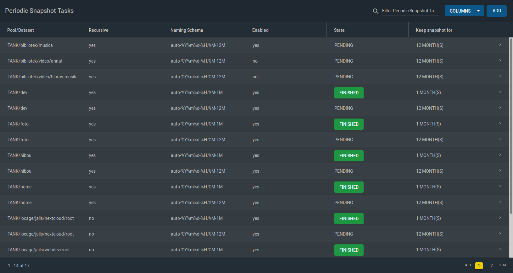

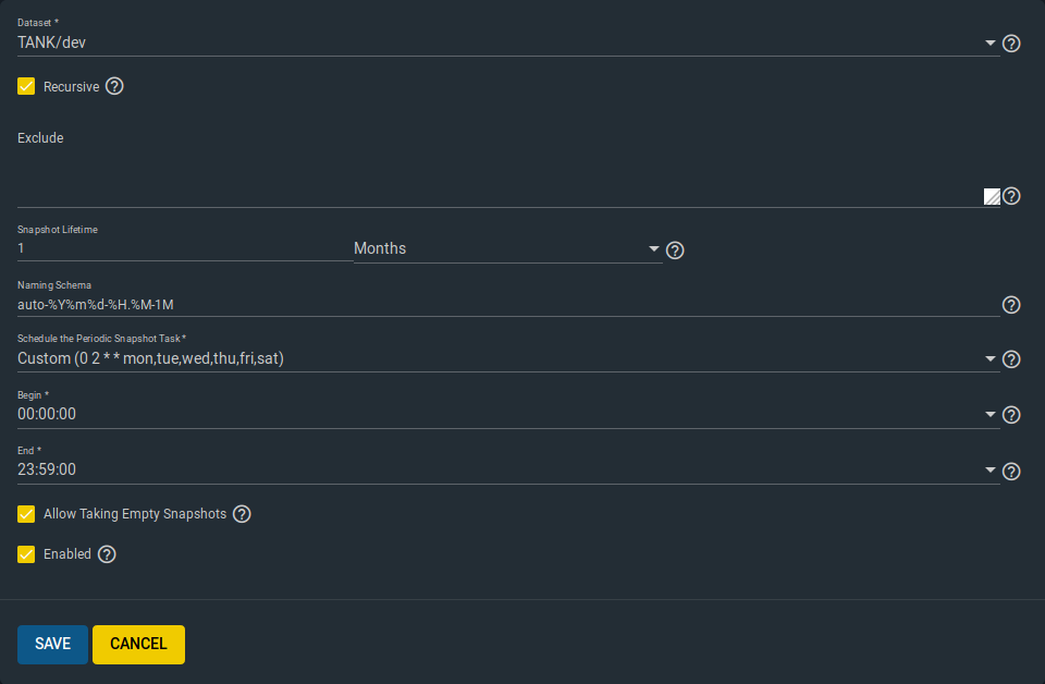

These are the settings I have used. The ones that are pending only run on Sundays.
