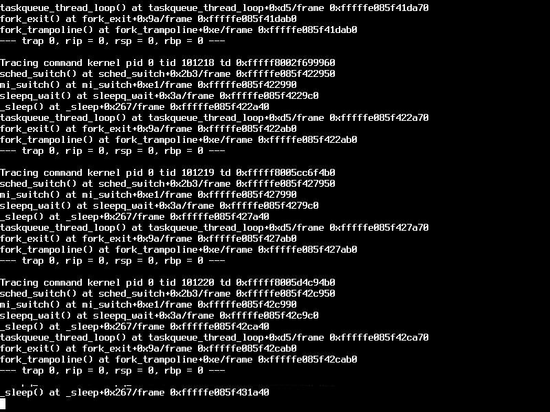

4. This is where my memory fails me... I either tried to shutdown the Syncthing Jail (from the FreeNAS WebGUI's Jails page) or restart it. The system became unresponsive, as did the PuTTY window I had open, luckily I had the good old IPMI iKVM window open which was going crazy and spamming text faster than I could read. Fortunately I managed to grab the following screenshot before the system rebooted. From what I could tell, all the other messages that appeared in the iKVM were the same basic format.
So, what happened? Did I just pop my kernel panic cherry?
There are some changes that you can make to a jail configuration that will crash the system. I ran into that a lot when I was using more jails. For example, PHP Virtual Box. That thing crashed my system a lot. Now that I am only using Plex, I hardly ever have a crash. You might want to consider upgrading to the latest version of FreeNAS if there is no compelling reason not to.

Just a little update. I've just had another crash with the same spamming of the IPMI iKVM Shell. This time though, I (sort of) hadn't directly changed any network related settings on my FreeNAS system itself. I've been trying to modify the config of my OpenVPN server on my pfSense box but for some reason, the dang OpenVPN client just won't get an ip. I refreshed / restarted / reset a few things of pfSense and I also restarted the Deluge Jail, serveral times in fact, so I did change network settings on my FreeNAS system but I have restarted the Jail one too many as my FreeNAS box crashed.
On the bright side, it looks like I've got a pretty good idea of what kind of monkeying around causes the crashes.
Any tips on avoid crashes when modifying network settings on FreeNAS?
(or perhaps I should hold of with fiddling about with things until I've upgraded to 11.x)
