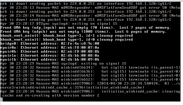

checked screen output... below...

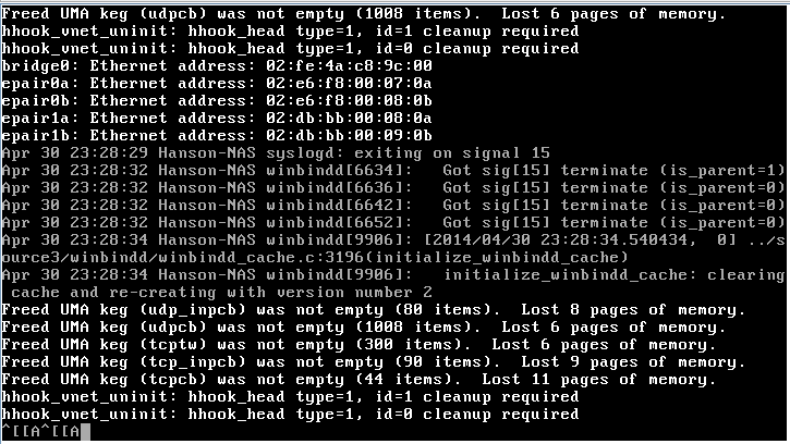

Hmmm it crashed again. Pic from screen output below:

warri
Jun 6, 2011
1,193
It doesn't look just a normal crash, the running processes actually seem to be ended gracefully (SIGTERM, exit code 15).
Also the terminal still seems to accept input (^[[A in the last screenshot).
Can you check the logs to see what happens before this? This information got cleared from the screen due to restricted space, but should be available in the log files at your .system dataset or /var/log

And it crashed again... Here's the link to the log: https://dl.dropboxusercontent.com/u/6447223/messages-3
Feeling stupid... Sold my Synology and spent a good amount of extra $ to build this "sweet" FreeNAS box, and I can't get basic stability... Grrr... Hopefully we can find a solution. I'll post a bug on bugs.freenas and see what I get.
