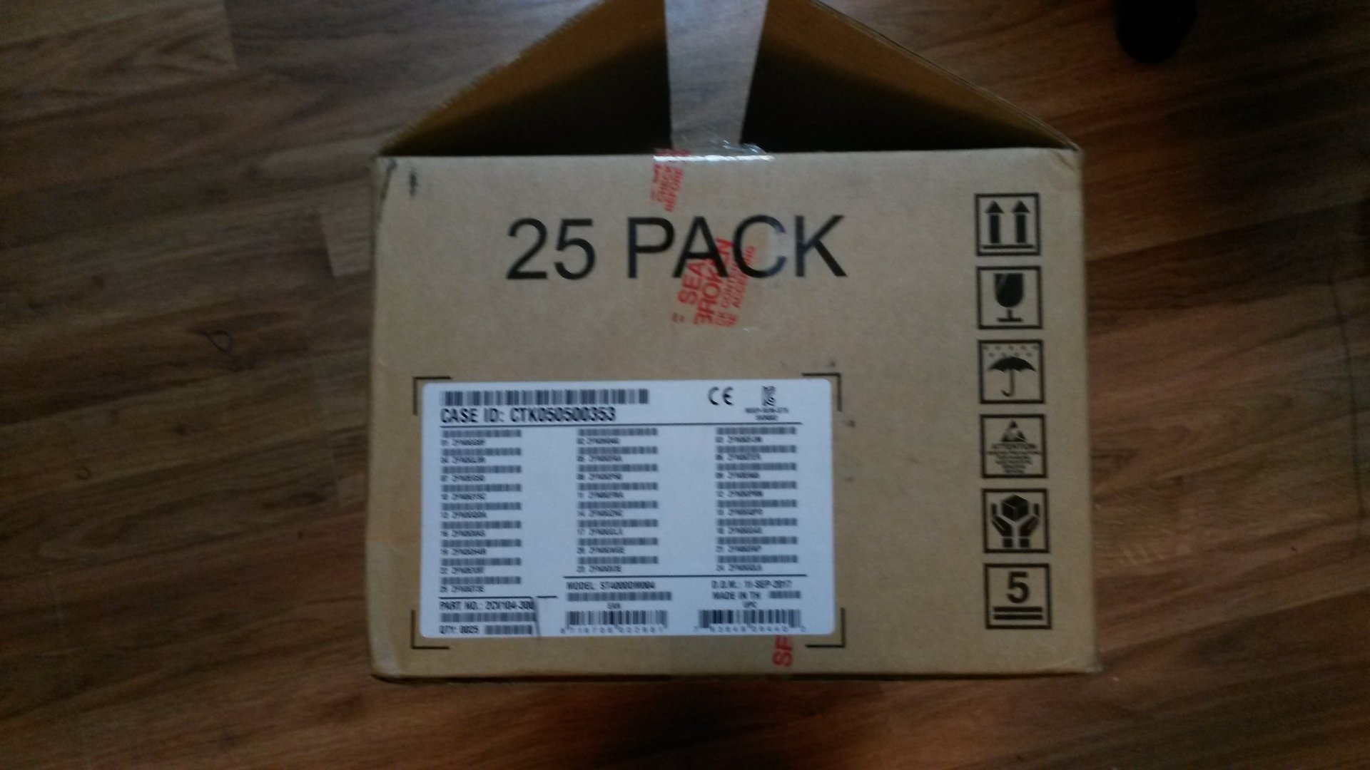

How do you accomplish getting disks from differt production batches so that most / all disks fail roughly at the same time
I wouldn't worry about trying to get drives from different production runs.
Where I work, we often get drives in by the 20 or 25 pack, like this:
I have about eight of those empty cases stacked up right now from purchases over the last year. and I have four 20 pack boxes of drives on order (12TB drives) right now to upgrade one of our servers that is currently running 4TB drives. We don't see a very high failure rate out of disks normally, less than 3% failure rate in the first year on disks purchased within the last five years, and the failures are not often batch dependent. For example, we bought 60 of the WD Red Pro 6TB drives two years ago and had three failures in the first six months, two more fail in the second six monts, but zero failures in the following year. In November of 2018, we bought 60 of the Seagate Exos 10TB drives and had two fail in the first six months, but they are not old enough yet to have more statistics. Even when we order disks in quantity like that, we don't often see concentrations of failures that would make us suspicious of a fabrication defect. It appears that the trend is lower failure rates with more modern disks. I remember a time when failure rates were higher, but they appear to be trending downward. I am eager to see how the 12TB drives we have ordered do once we get them in service.
