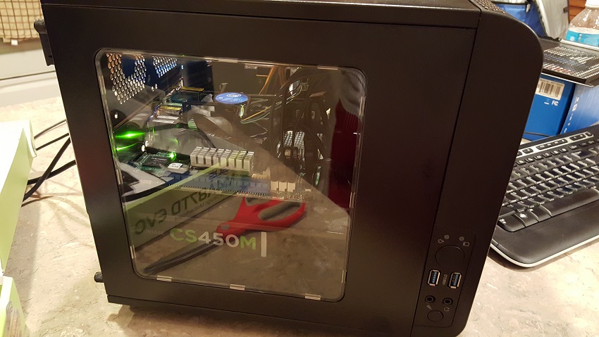

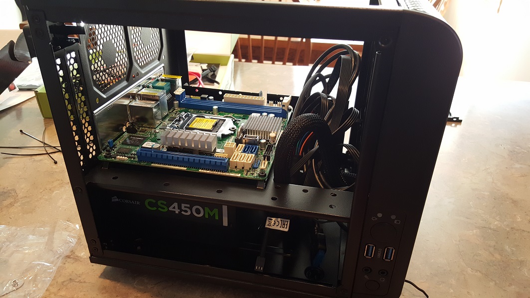

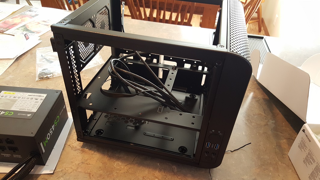

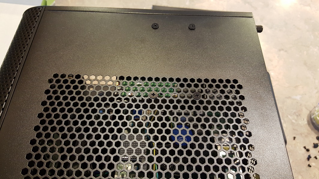

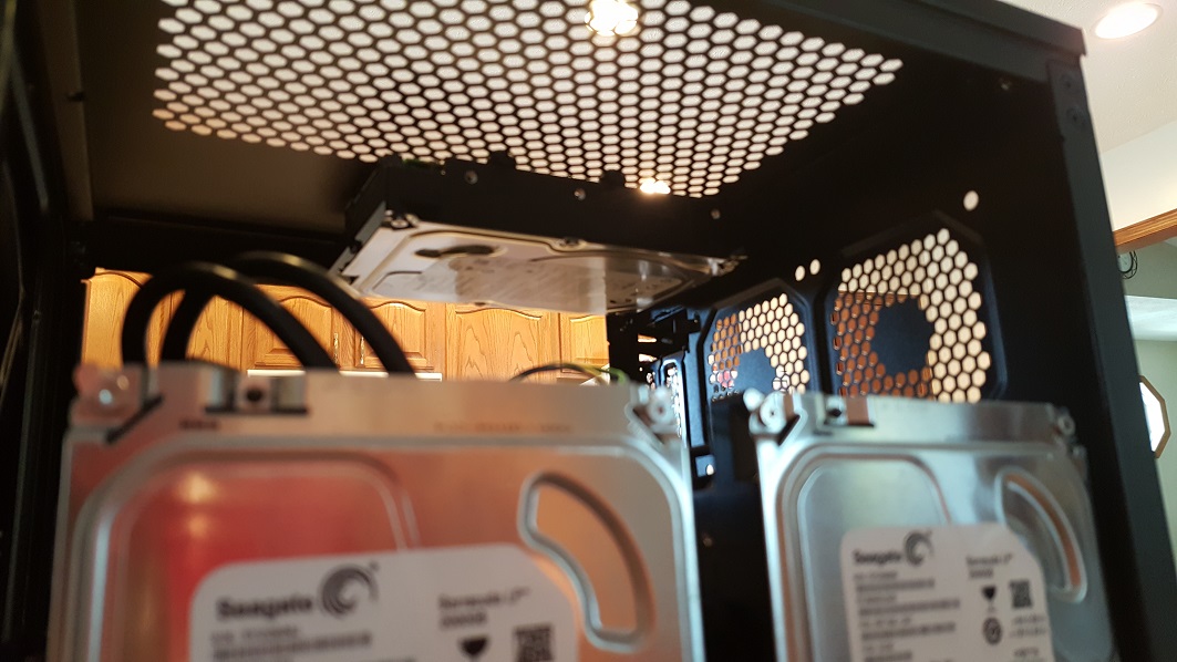

Hello - a few months ago when I came across the whole NAS concept, I knew I had to have one. I started researching, and slowly putting parts together. I ended up with the following hardware:
Thermaltake V1 Case (Modified to Accomodate 3 Hard Disks)
ASRock Rack E3c224d2i Motherboard
Intel Celeron G1820
16gb ECC Kingston Memory
2tb Seagate Barracuda LP Hard Drives x 3
Corsair CS450M PSU
Sandisk 16gb Flash Drive

I want to make sure that I have everything set up properly in case of failure. As you can see above, I'm running a RaidZ1 configuration with only 3 hard drives. I've read a lot of good and bad with this setup....can anyone chime in?

The drives you have are consumer desktop drives so you will want to make sure that your not idling them as FreeNAS will write to the array at different intervals and the parking process is what causes issues with a lot of the drives. I am still building out things as I am on a tight budget but have a pair of laptop drives and it works fine just though with the HDD standby set to "Always On" The reason why raidZ1 is not recommended is because when one drive fails and you replace it and then begin the process of resilvering the other two drives are stressed which can cause another failure with the drive capacities getting larger and larger the resilver time is increased so the stress time is increased and the window for potential failure is also increased. Should that happen kiss your data goodbye. So make sure you have backups of everything that is there.

Thanks for all the replies. I did run Memtest86 on the ram, approx 3 passes with 0 errors. I did not know about Badblocks though. I'm using these Seagate drives because I already owned them, and like a lot of people, am on a tight budget when it comes to this, so just using what I already had. I did set the 'HD Standby' to 'Always On' as recommended. I also saved the Config file under 'System -> General' to my laptop computer, and will continue to do that whenever I make changes in the GUI. And I followed Cyberjock's guidelines to set up the SMART and scrub tests.
Maybe I'll have to upgrade the hard drives sooner or later and go to 4 drives total, for better redundancy. I have an external hard drive that I'll use for now to keep everything backed up also.

In the case of the OP I would think adding another drive and setting up a RAIDZ2 over a RAIDZ1 would be the most beneficial addition to the current setup.
