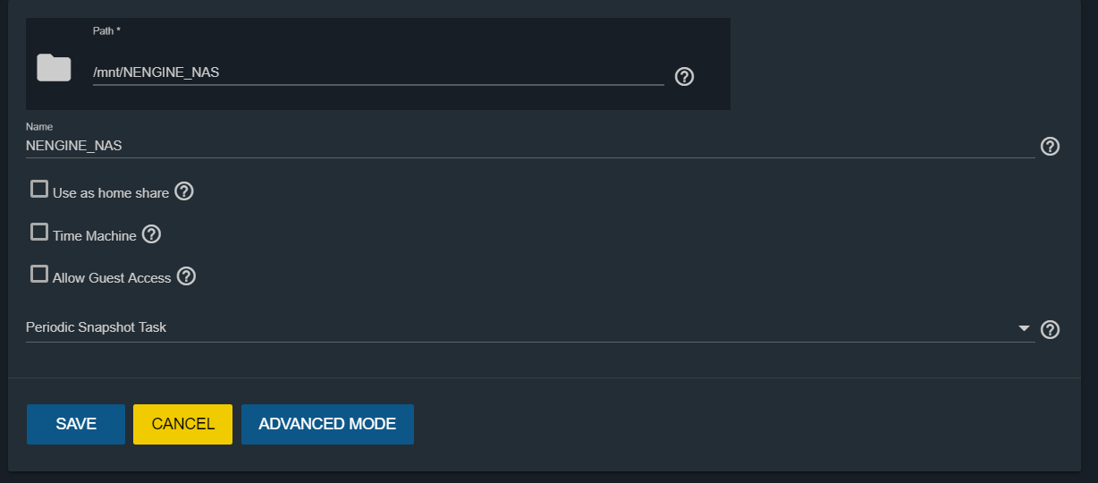

1. I'm talking about access to a share.
2. Windows SMB
3. Well, i'm not very new to FreeNas so i'm not very familiar with it, so i'm not sure about creating a different user and configure it properly...
4. Yup.
I cleared completly the Windows Credential Manager, nothing changes, it still says me that either my ID or my password.
